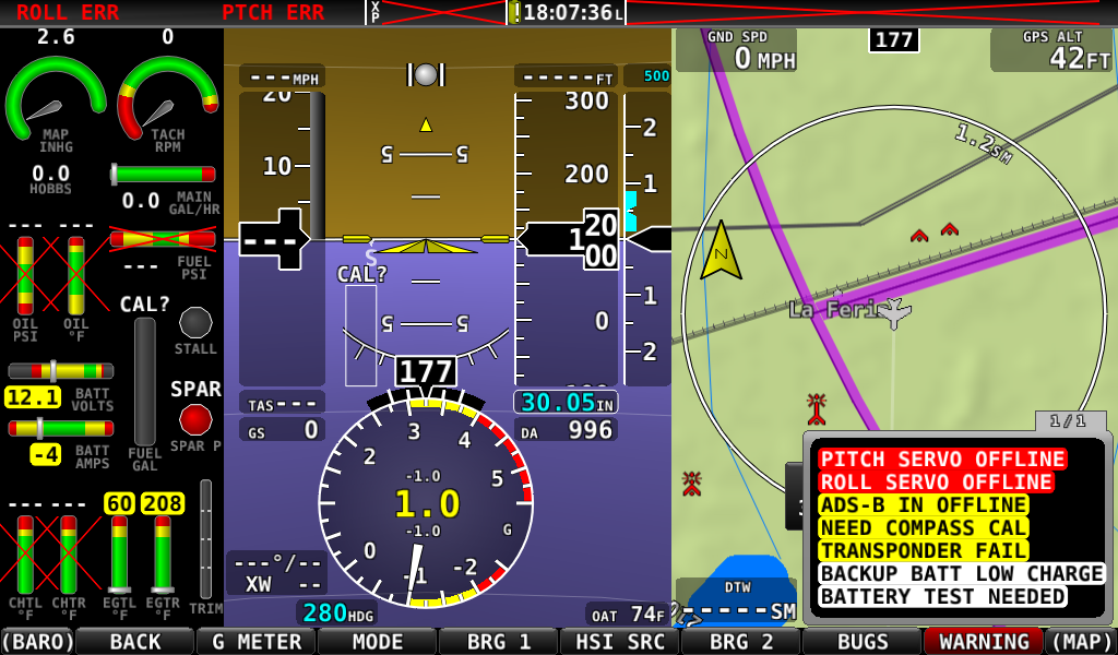

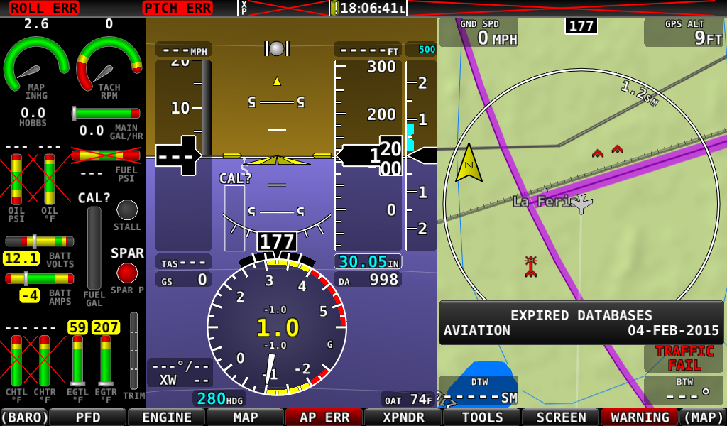

My ADAHRS bit the dust, got it back from Dynon all repaired, now this shows up.  Do I need to reinstall these things?  Autopilot servos and transponder were working fine previously, as well as ADSB-In.

You likely don't have power on a bus that powers the servos, transponder, and ADS-B.
You will need to do a compass cal since it's a new compass.

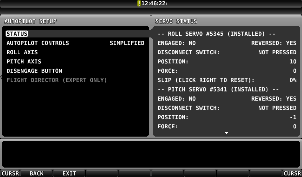

Was not able to find a "Servo Test" but maybe this screenshot might help, should it read "Reversed: Yes"? I was unable to change the yes to no.

Page 10-16 of the Install manual.
There's no issue with reversed.

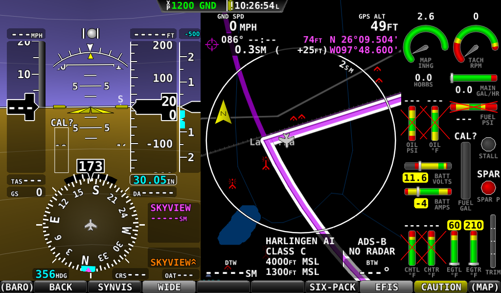

OK, does this look more correct?  The airplane was right side up, the ADAHRS was upside down!

It looks like you may still have some more re-configuring to do. The AP does not look to be configured (evidenced by the lack of the AP bar status area in the top-left portion of the top bar. After you did your SkyView Network configuration, you would need to go through the AP servo calibration process so that the system sees your servos (you shouldn't need to adjust the gains and other AP settings, but you need to make the system aware of the new ADAHRS/servo combination. It's also not clear why your COM radio status isn't being displayed anymore. Give us a call at 425-402-0433 so we can give you some more personal attention here.
