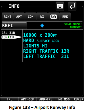

What does the green arrow between 13R and 31L indicate ? What does it do ? When you click on it, it changes direction.

If you hit the "Direct To" button, the NAV will take you to the approach end of the runway it's pointing at, with the parameters you set in setup (altitude, distance, etc.).

However, I was unable to get HITS to that point show up on the display. And vertical guidance terminated once I got to this point. It would be great if it continued to the threshold :)
1,181
That's getting into the arena of an instrument approach, giving guidance all the way to the runway. Unlikely you'll get that from Dynon.
