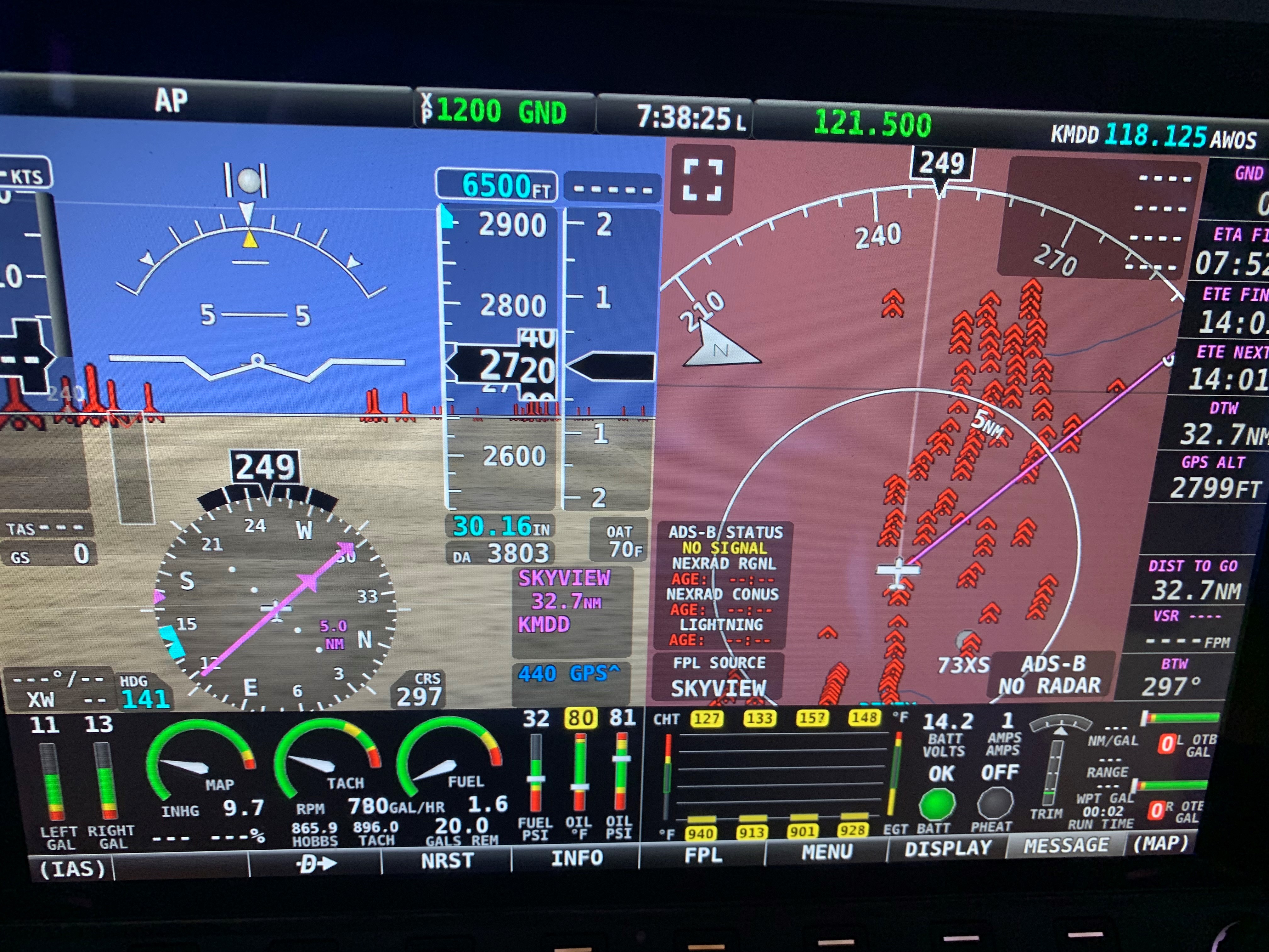

And apparently it only affects the Classic screens - my HDX is unaffected running 16.0.4.
