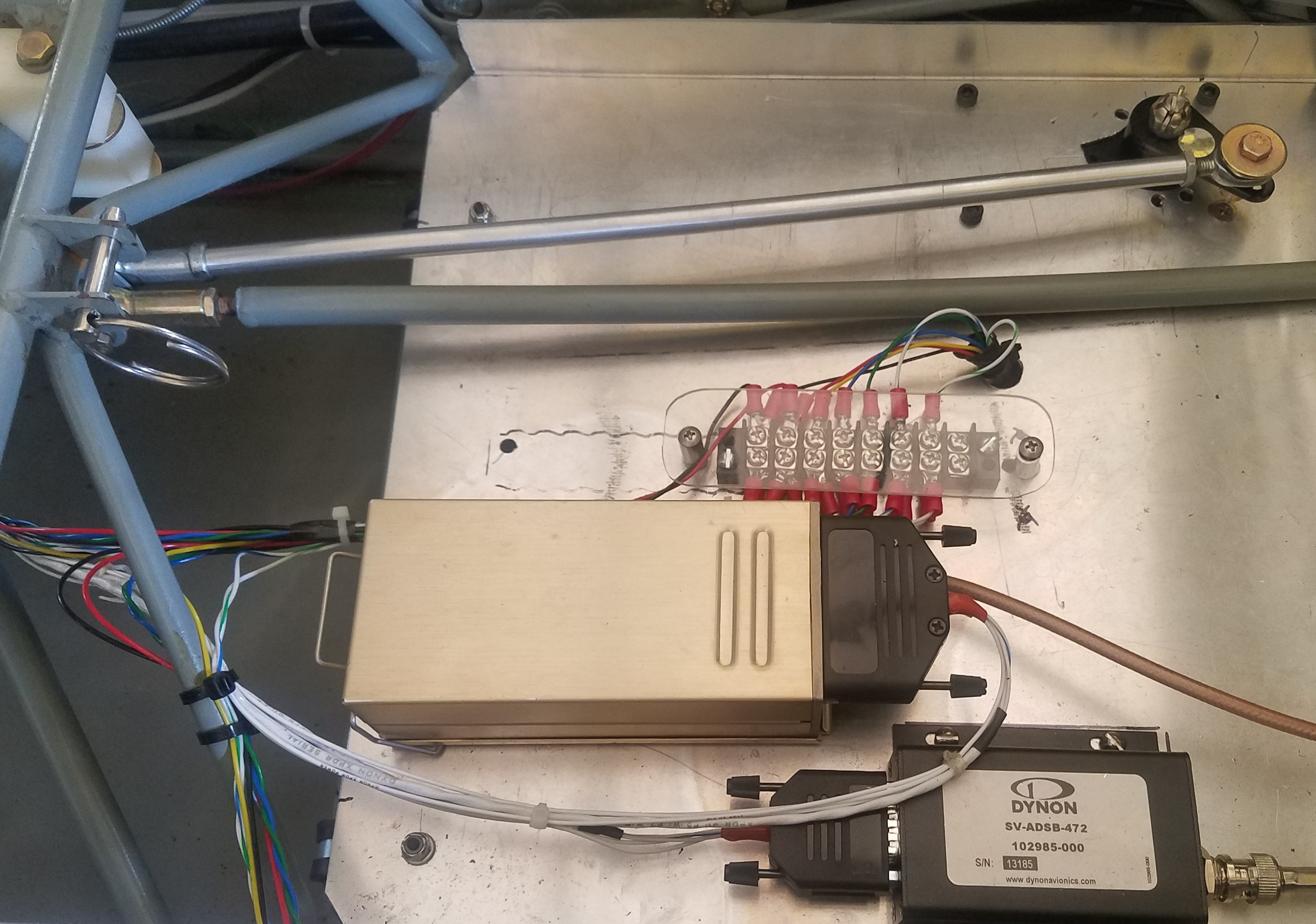

I thought that my recent installation of a Dynon autopilot system might be of interest to others making plans. My plane was already covered, so
we decided to mount the pitch servo under the left seat and connect the push-pull tube directly to the bottom of the control stick. With the servo mounted under an aluminum plate (which also serves as the mounting plate for the ADS-B receiver and the transponder). I did not like the idea of putting the servo aft of the baggage compartment. First it would be difficult to work back there (I weight too much and am too big to fit easily), second inspection is a problem and the under seat access is great (I put a quick release pin in the seat attachment). Perhaps worth noting, I did not buy the connection blocks for connecting the servos as I thought a simple connector would be better. Less connections/fail points, lower cost!
