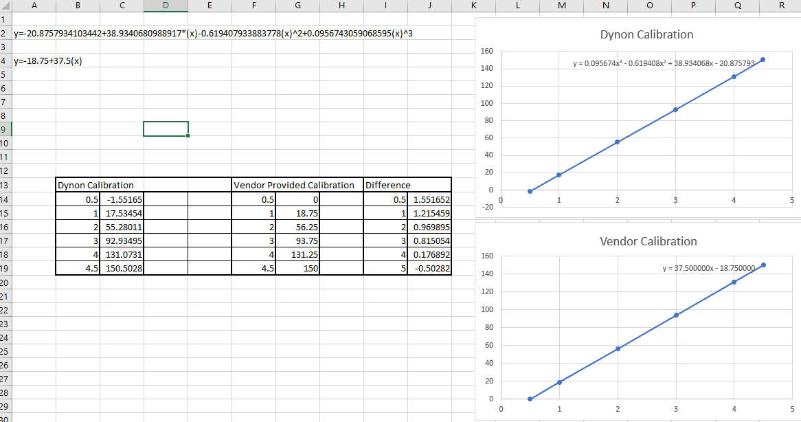

I plotted both of the calibrations and do not see much difference in the EU conversion, but are we giving up some accuracy? Especially at the low end? See difference column below. Are you applying an non-linear characteristic or calibration of the the Skyview system?
I am just curious as I have provided calibration coefficients to others. Want to make sure I am not omitting anything.
