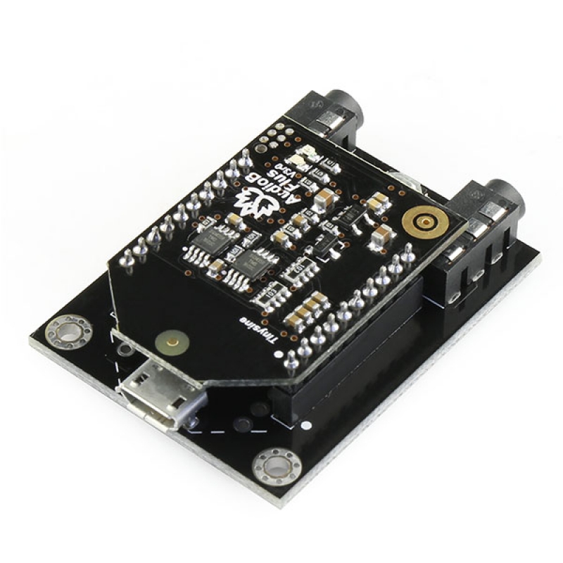

I ended up using a Tinysine TSA6015 Bluetooth module:
Bluetooth%20Audio%20Receiver%20with%20Microphone%20Input%20(Phone%20call)-1-800x800.jpg
The TSA6015 is very much a developer's sort-of-module: no box is provided, and you need customize the firmware settings a bit in order to get it to work well in this scenario, so buyer beware. This setup lies squarely in the "experimental" part of "experimental avionics"!

Audio playback worked out of the box, but I needed to change some firmware settings in the TSA6015 in order to get everything to really work. Follow the guide on TinySine's site to do so; you'll need to also buy the Qualcomm programmer as well as the TinySine Tag-Connect line kit: https://www.tinyosshop.com/index.php?route=information/news&news_id=96.
  • Change to single mic mode: In order for the line-in functionality to work, the "HFP Plug-in" (hands-free profile plug-in) needs to be set to "CVC HandsFree 1-Mic". This is done via the ADK Configuration tool, under the "Voice" configuration menu. If this isn't done, folks on the phone won't be able to hear you at all.
  • Reduce input gain (optional): The output signal to the TSA6015 might be too high, depending on where you like to have the SV-INTERCOM-2S volume knob set. This shows up as clipped / compressed-sounding audio on the phone. To turn down the TSA6015 input gain, use PSTool and search for input gain settings; they can be turned way down.
  • Disable LEDs (optional): Since I mounted the TSA6015 upside-down on the bottom of my intercom, it lights up the cabin with a bright blue LED -- not great for night flying. I turned off the LEDs using the ADK Configuration tool; go to "User Interfaces -> LED" and change the "LED A Mapping" and "LED B Mapping" to "N/A" for the Default Pattern. I also deleted most events since I didn't feel they were relevant.
  • Rename the Bluetooth device (optional): Out of the box, the TSA6015 shows up as a Bluetooth headset with the name "TSA6015". Lame. I changed the device name to my tail number.
