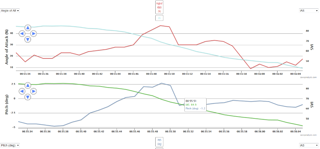

I always wondered what the IAS was when I landed. Like everyone my eyes are outside. I upload my logs to Savvy all the time so I checked a few landings. It's nearly always the same IAS on landing. You can see on the graphs below, both the pitch and AOA break when I touch down. The pitch and AOA are increasing as I hold it off.
The IAS is about 65 kts when they break. Same results on all my *good* landings. ;)
Another thing to note is my approach speed of 85 kts IAS. Lots of interesting stuff in the Savvy reports other than the engine analysis.

NICE!!!
You inspired me to go on SAAVY Reports and looked at my last 5 uploaded flights. Amazingly enough on every landing the AOA was between 74 - 76% while the IAS was between 60 - 65Kts. And I never looked at any instrument below about 500ft AGL. The darn thing actually works as advertised.
