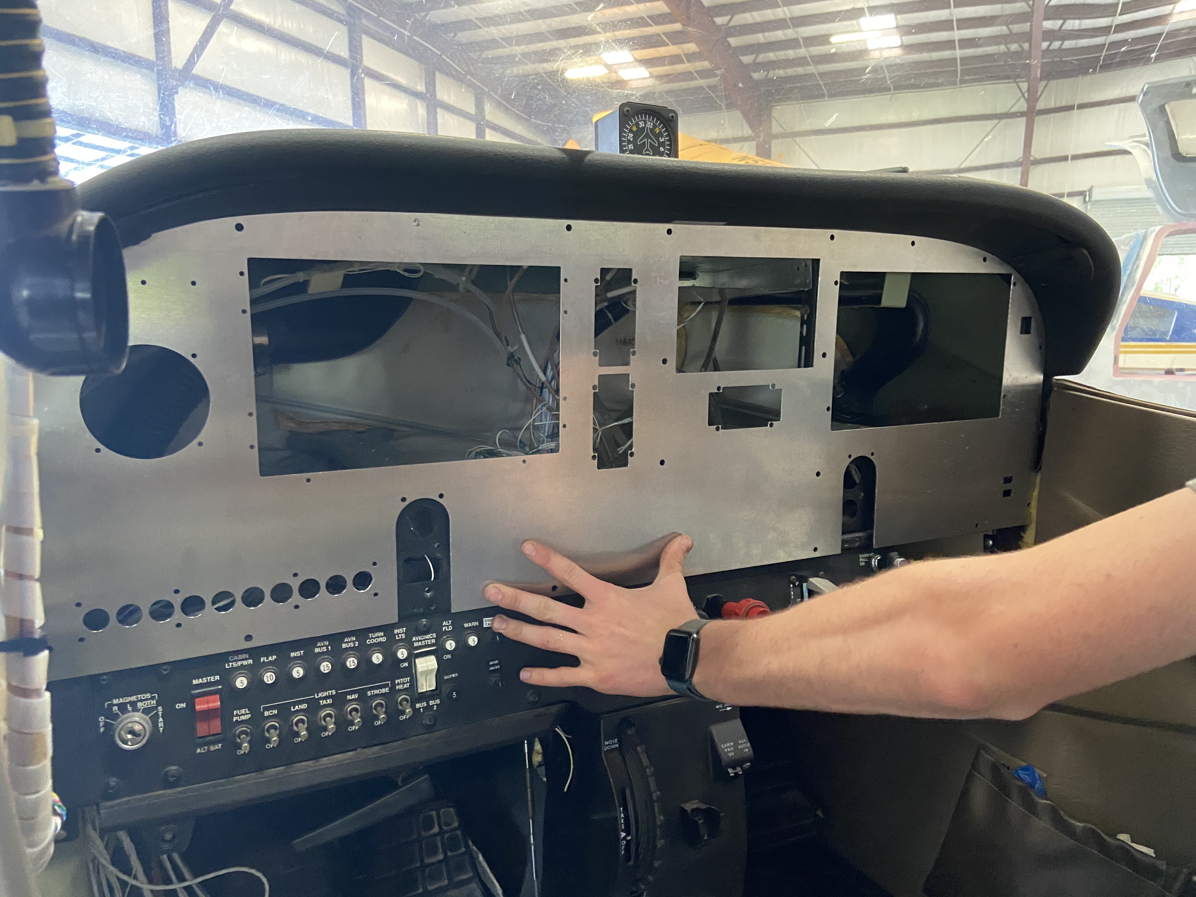

I recently purchased a very original 1973 Cessna 172M; 2800 TTAF, 580 SMOH (LyCon) and an unmolested original panel. I fly in the Pacific Northwest and plan to add some capability to the panel to reflect the type of flying I do and the airspace/geography I operate in. Dynon is local to me and I love their business model and ethic, I have eagerly watched the development of the Skyview system and intend to put a certified Skyview HDX in my 172M.
My question to this group is has anyone put a 10-inch display in a 172M? I know the 10-inch display fits in the N (and newer models) panel but the higher yoke position of the M model leaves little room. I have considered a 7-inch display but taking the easy route has never been my thing. If you have a 172M and would also like to install a 10-inch Skyview HDX please chime in, this probably applies to the K and L models since they have the same yoke position.

Not an early model - this is a 2001 R model - but we just had twin 10" HDX's installed. If you have a good measurement tool or calibrated eyeball maybe this will answer your question.

Wow, that looks great! is that an ipad or an mfd in the center stack location? I'm planning to have everything ready for a second monitor when I decide to add it.
