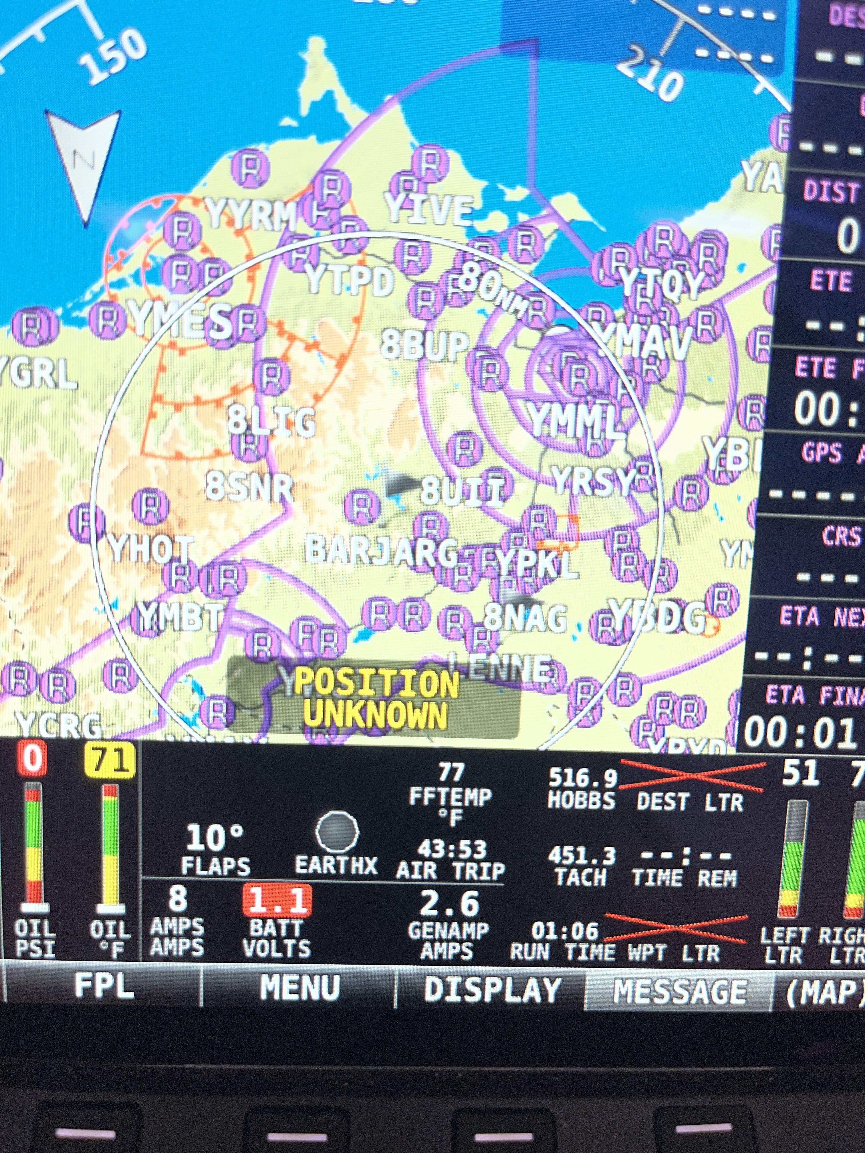

When I powered the Dynon HDX with the Dynon backup battery alone, to check that my newly installed EGT probe functioned ( it did) ,I noticed the Ammeter reading was 8Amps and the 'measured output ' from my Monkworkz input was 2.6 Amp. Obvoiusly, the only power supply in the plane at the time was the Dynon supplied back up battery.
Can anyone explain this to me? See the screen shot of part of my monitor at time.
