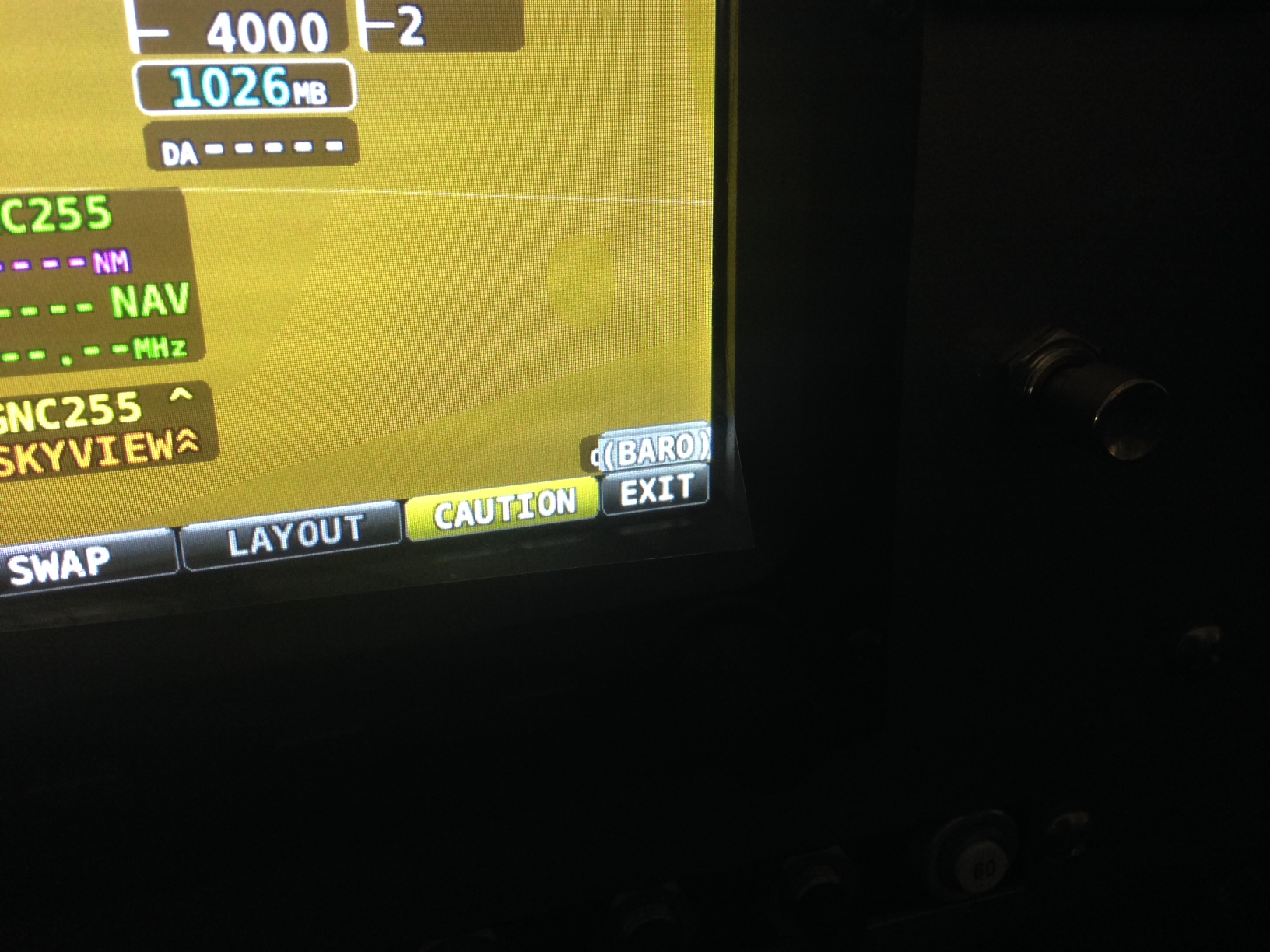

Busy with a new installation. Two 10 inch SV touch screens. Yesterday at some stage during testing, I noticed the LH screen joystick are "stuck". The LH one on Baro and the RH one on Map. Cannot get them to show the other options. Mechanially both seem ok. I can feel and hear the clicks when operating them.
The RH screen is ok.
What did I do wrong?

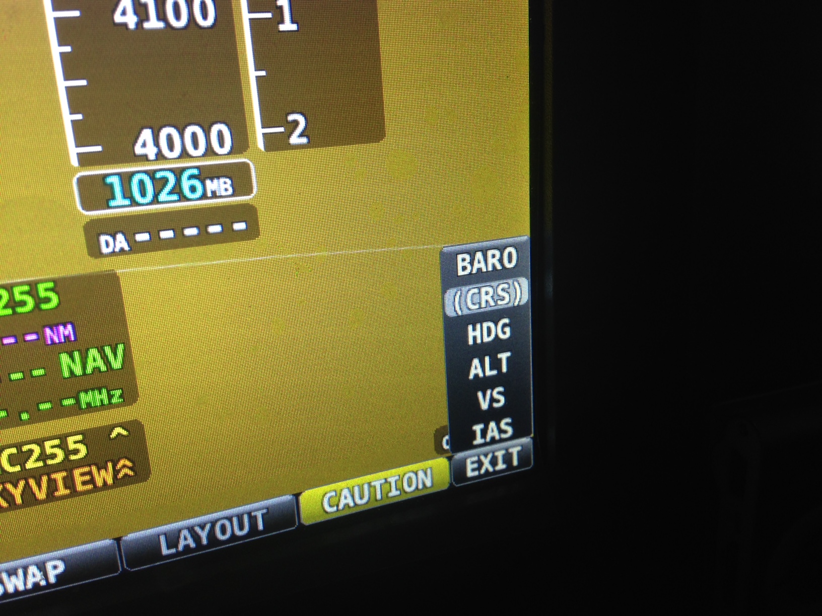

The MAP knob is "forced" to MAP on the side of the screen that has a MAP displayed. If you click it up/down left/right the map should be panning. Or go into a map menu and make sure it navigates.

Ok - Agree that on map it is forced on map.
I went to Setup and can scroll up and done and left right with it - no problem. Then I have made both screens EFIS only. On the RH one you have the usual functions, bit none on the LH one. See the picture attached please. Again it did work normally up to a point yesterday.

Go into your PFD menu and select bugs. On your LH screen, you have the IAS, CRS, HDG, VS and ALT bugs turned off.
However, these should be synchronized if the two screens are networked together. When you adjust baro on one screen does it change on the other?

Done and self inflicted problem solved. I though I had done something wrong. :-[ All the Bugs were switched off.
Thank you very much.
