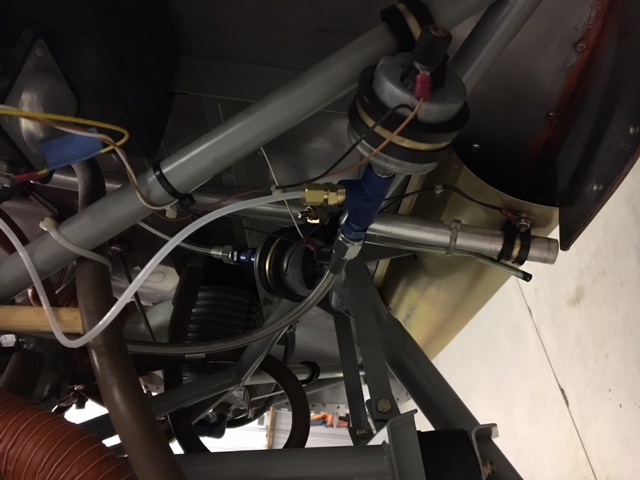

On a recent flight, as I rolled onto the runway and lined up, I flipped on my electric boost pump. Almost immediately, the Skyview system gave audio warning of "fuel pressure" which gets your attention. Looking down the value was bouncing around from 45-60+ psi (fuel injected IO-360 with Airflow Performance pump to a Bendix injection system). With the boost pump turned off, the value dropped back to the normal 33-35psi. After discussion with Airflow Performance, they suggested connecting a mechanical gage into the system near the sensor. Sure enough, the mechanical gage reads fine (33-35psi, then adds a few psi when the boost pump is on) while the Skyview reading was all over the place, much higher.
So I have a bad sensor, but this failure mode is confusing, since the sensor appears to operate normally without the boost pump...

I was slightly confused by your post (no reflection on you) until the replacement sensor arrived.  My original sensor bought about 2010, look like the one in the photo.  It has provisions for only one wire to attach on the terminal, and the instructions say to simply run a ground wire under the Adel clamp to ground the body of the sensor.
The new sensor is about 1/2 the size of the old one and has 3 wires.  So apparently I had a VDO-style sensor...

Sorry, your subject heading was for Kavlico Feul Pressure Sensor Failure so I gave input based on that - the symptoms you have/had are typical of the VDO (that’s the one in the photo) units & that’s one of the reasons why Dynon don’t sell the VDO ones anymore.
That picture - hopefully the plastic line setup was being used for ground testing only ? ;)  which Glasair model do you have ?

Yes the plastic line was simply for a ground test run to see if a mechanical gage would read "normal" pressures while the sender gave the high readings. Just wanted to eliminate the pressure relief valve in the boost pump as a possible culprit.
