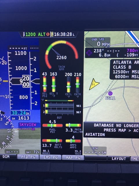

I recently purchased a pre-owned Just Aircraft Highlander with a Rotax 912 ULS. When the Engine type ROTAX S/ULS is selected in the setup menu, the tach range appears incorrectly. Notice in the photos below that the oil temp is well above 120 degrees and the tach green range is very limited. Any ideas why?
Also, the option for combination CHT/EGT is not available. Is that because the EGT is named 1 & 2 while the CHT is L & R?

So the tach has a dynamic yellow range for the tach (and oil temperature) based on Rotax's operating rec's (avoiding higher rpm until the oil temp comes up, and having a different coloring scheme on the oil temperature until it's hot enough to boil off off any water that may have collected, which is supposed to happen once per flight). Below is the excerpt of the behavior.
For the behavior to work, though, the oil temperature needs to be configured as the pre-canned name. In your case, it looks like your oil temp gauge has a lightly nonstandard renaming. So you have one of two options: In you pin mapping setup, reset the oil temperature pin (usually c37_p7) to have the default OIL name (instead of the OIL T name it currently has). Or, if you prefer, you can just set your engine type to OTHER, and then you'll likely need to manually configure your oil temperature and rpm ranges.
