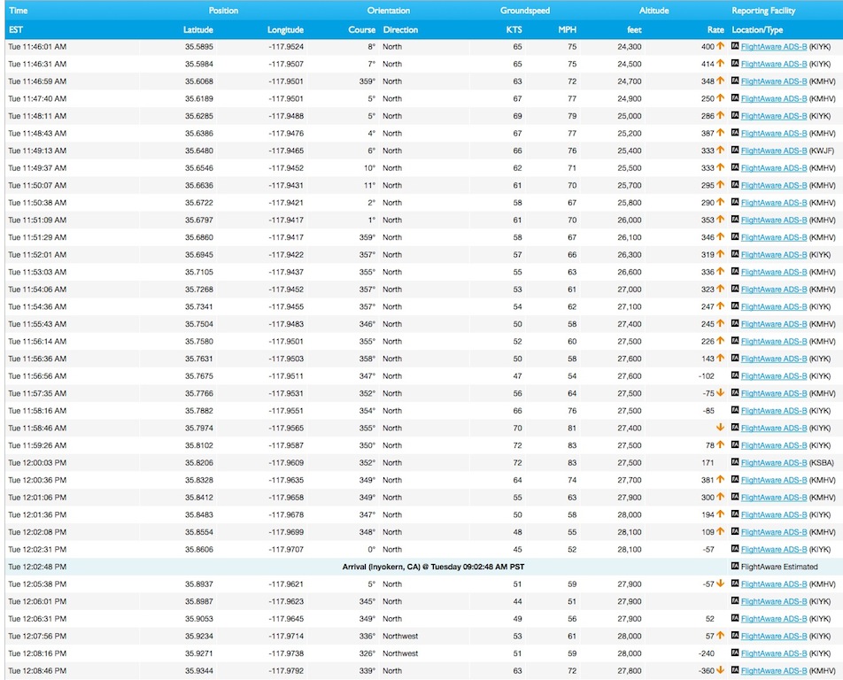

Wow! 28,100 ft! Was this an experiment or mission related?
nigelspeedy
Mar 15, 2010
101
CA
Testing my plane is the capstone project for a masters program I am doing. So the ceiling climb was part of the climb performance testing for that. Also just wanted to know how high just in case someone asks. Pretty sure others have been higher, I think I read a Kit Planes article about an RV-7 and he got to 30k and I am pretty sure a Rocket would get higher as well. It is more of an aeromedical challenge than a flying one. Everyone likely thinks about hypoxia but don't forget you run the risk of DCI and the cold is miserable so above 18,000' is possible but not really practical.
