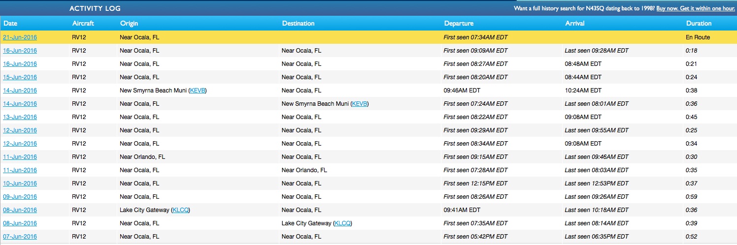

Flightaware shows you just fine. But they can correct most of the time if you have a bad N number entered or a bad ICAO code entered.
