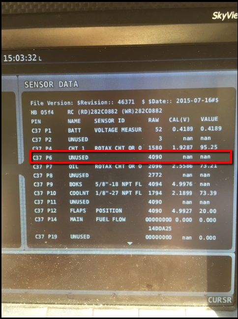

After winter storage, when I was starting up I had no oil pressure signal.
On skyview is only a red cross over the instrument.
Oile sensor Rotax P / N 456180. Is this the latest sensor?
Is it right that this has only have 2 lines. Power and signal. No wire to ground. Ground comes from metal on the engine. Is this correct?
We tried to put ground on the connector to EMS and then we could see the number 4090 (on picture) changes. So then we know that there is a signal from the oil connector to skyview / EMS.
I have not checked the red wire from Skyview / EMS actually provide 12V and signal provides 0-0.5 V. This I will check tomorrow.
If the wires from EMS delivers the correct voltage there must be something wrong with the oil pressure sensor.
Is there a procedure to check whether oile sensor Rotax P / N 456180 actually working properly?

So if it was working before, this is pretty odd. It looks like that pin was unselected in the EMS sensor input mapping menu at some point (which can't, to my knowledge, happen by itself). So first let's fix that. Go to SETUP MENU > EMS SETUP > SENSOR INPUT MAPPING and on pin 6, choose pressure, the correct sensor (it's obviously named w/ the Rotax part number), and then OIL in the right most column. And then hit save. Does that fix things?

Hey, thanks for the reply.
Yes I've tried that. I save on Rotax P / N 456180, but it will not save this. When I go into and in again, I can see it have not been saved.
Why will it not save the right sensor?
I have also checked that there is powver to the sensor. Red wire provides 12V and signal provides 0.5V.
Ground comes from motor.
What can be wrong? Can it be a ground problem on skyview?
Are you selecting values for all of the columns? When you hit save, do you get any kind of a prompt? Try saving, then exiting setup, then re-entering setup. Does that change anything? If not, give our support team a call at 425-402-0433 or an email at support at dynonavionics dot com. We have a procedure that should fix this issue of settings not saving correctly.

When you changed the sensor type, you didn't give it a name. It warned you as you exited that the entry was incomplete and you keep saying yes.
After you chose ROTAX as the type, you need to go to the right and select the name "OIL".

Hi
I have done that, and sensor is now showing right sensor type.
But there is no signal. It show constant 3 bar. seepicture
Even if I disconnect the contact it show 3 bar.
Is there any way to reset/restart this sensor debugging?
I have also changed to a brand new sensor. I have check that wiring is going from right pin to contact.
Also mesure the V in wiring, 12V on red and 0,5V on signal. Ground is coming from the motor.
What is next step?

You should not see demo mode on your display, and this actually explains what you're seeing.
Demo mode is something that you need very specific files to load that we do not distribute (it is not a menu-configurable option), and it should never be on an airworthy airplane. The MAP, Tach, and other engine readings are showing static pre-programmed demo values. So right now, your actual sensors are being ignored. What is really strange is that it sounds like this airplane was previously flying before the winter? Was it? If not, was this display or aircraft ever part of an aircraft manufacturers' marketing demonstration? Has this aircraft been previously flown?
Please send our technical support team an email at support at dynonavionics dot com with a link to this thread. We'll send you files that will turn off demo mode.
