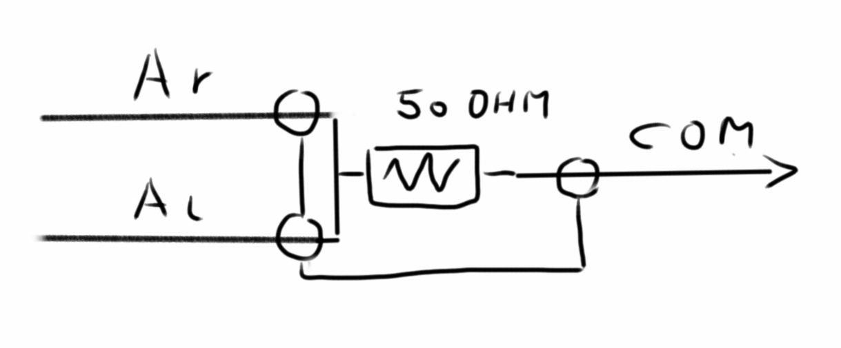

Same problem here. The noise is constantly opening the squelch of the external-in of my radio. Volume of ext-in is on lowest level and Dynon out on 35. Sound like the resistor can sort my problem. What I don't get still from your description:
If you hook a 50 ohm resistor between the audio output of the SkyView and ground
is how exactly this needs to be done.
I would simply connect like drawn in the attached, would this work?
The resistor hooks between SkyView's audio out and ground, not in series with the intercom:
Code:
SkyView L------|
               |----------------------|Intercom
SkyView R------|             |
                          resistor
                          GROUND
