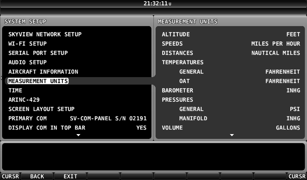

Does the Skyview system offer options for non-US units of measurement such as Hpa for altimeter setting, liters for volume and degrees centigrade for temperatures?
As rvator51 said, Yes. SETUP MENU > SYSTEM SETUP > MEASUREMENT UNITS. See the attached image.
Hpa for altimeter setting - no.
Liters for volume - yes.
Degrees centigrade for temperatures - yes.
