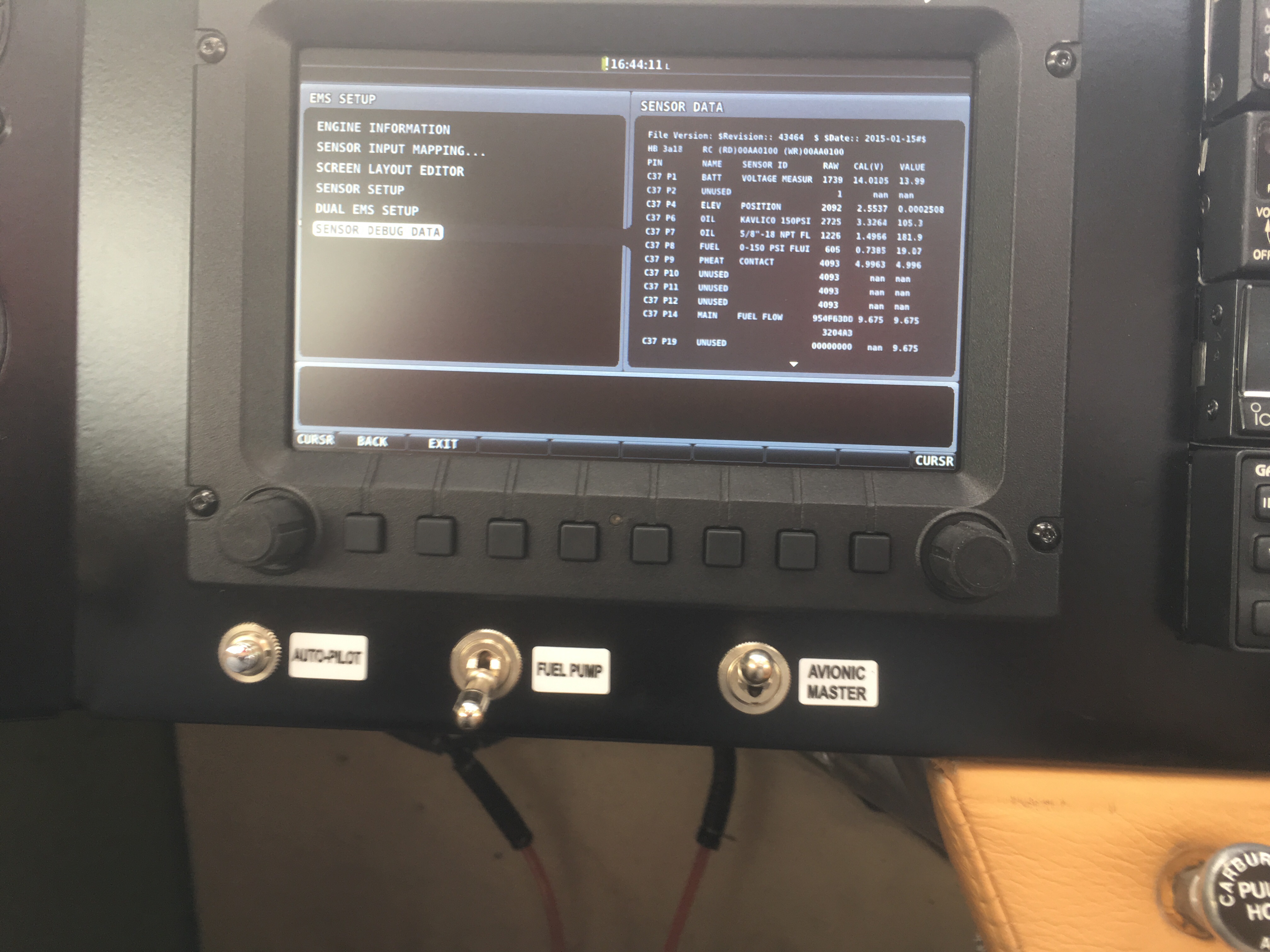

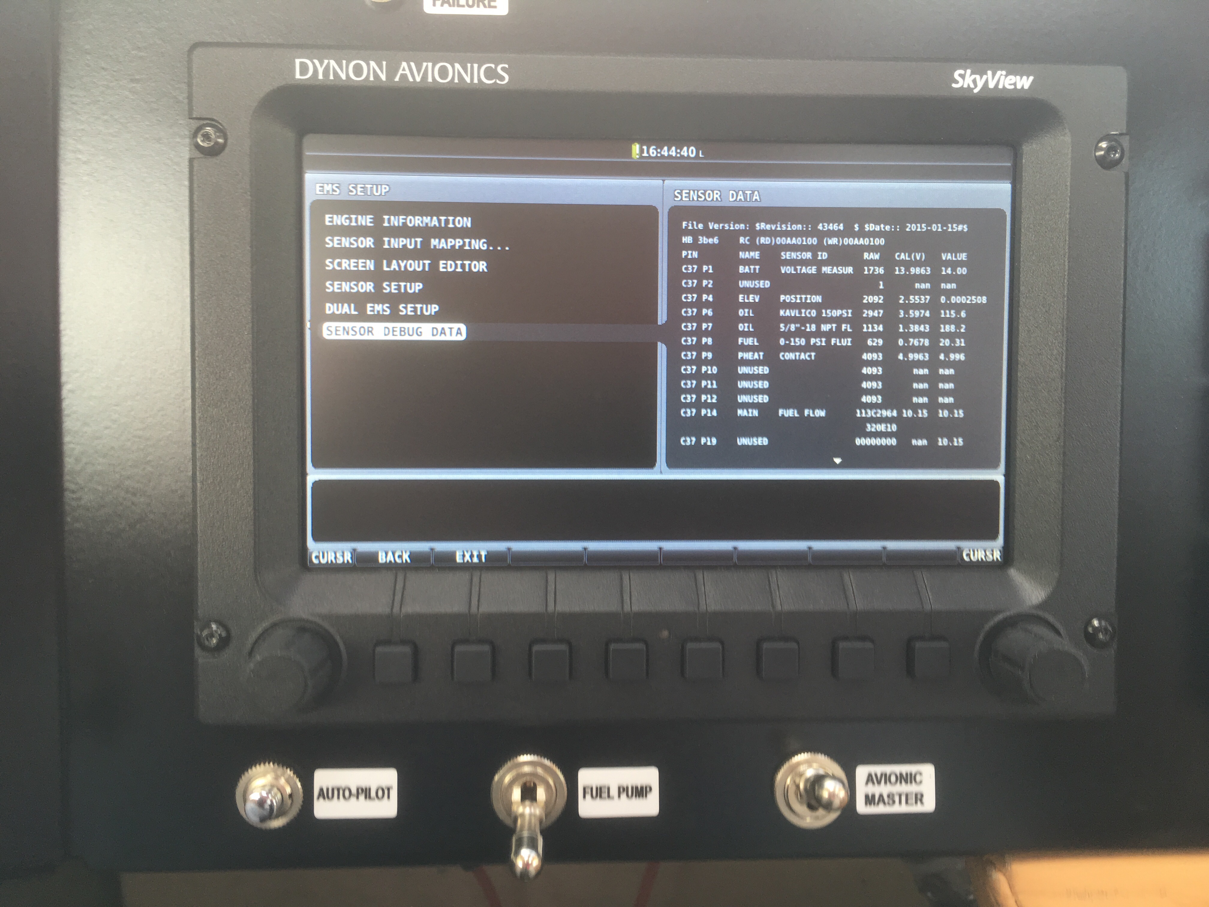

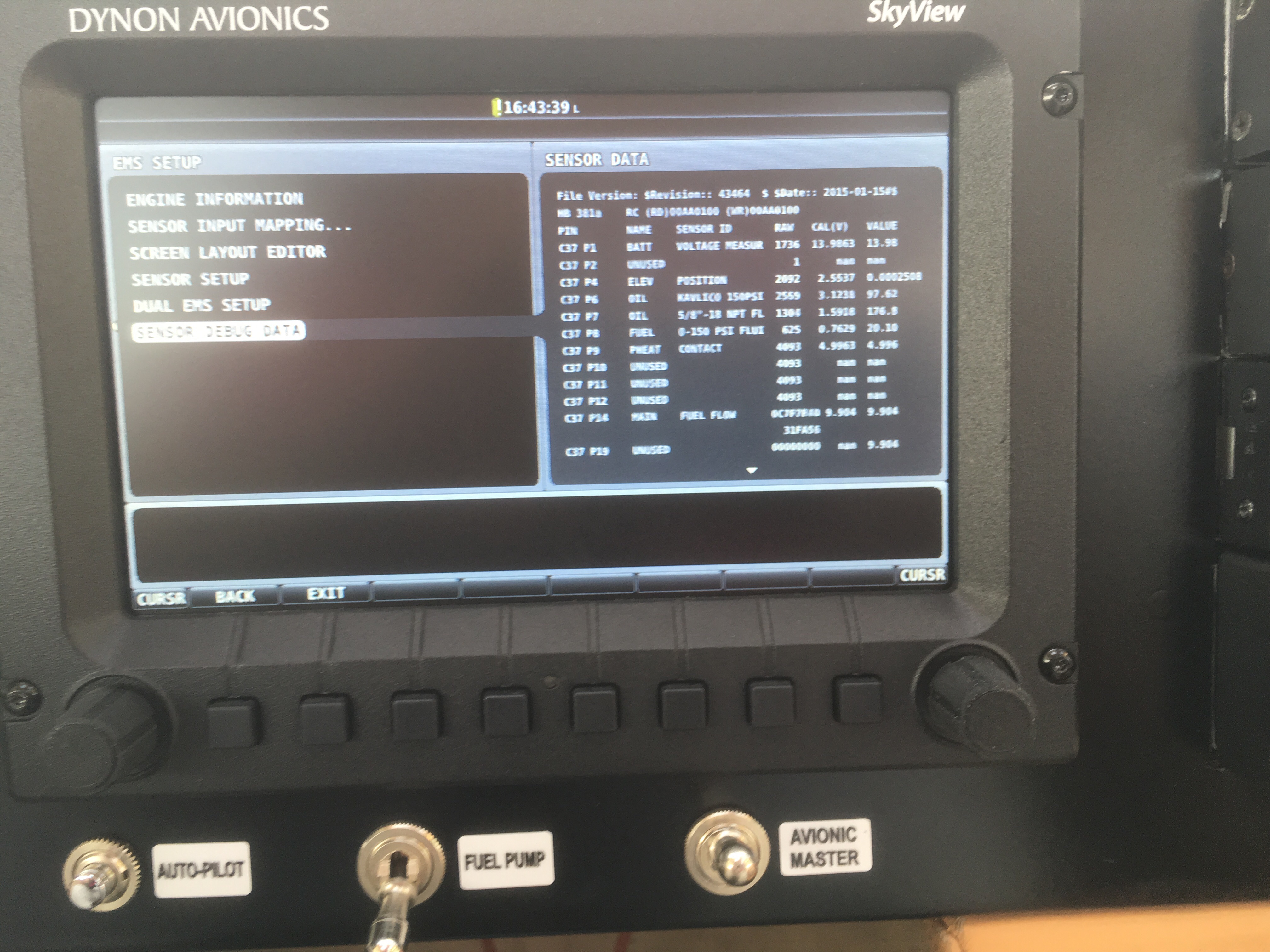

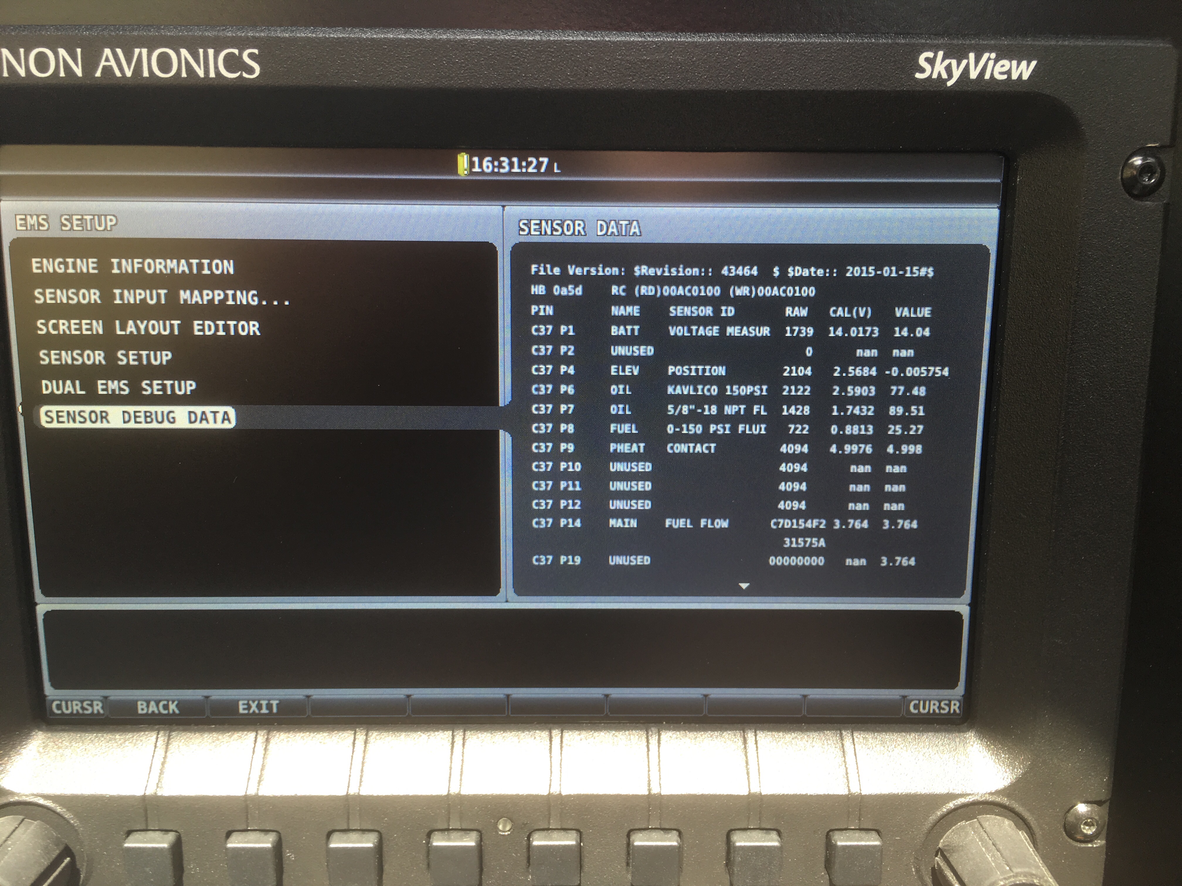

The fact that you have two different sensors with two different characterizations reading equally high is odd. Grounding can definitely cause issues, but, it's oil temperature that is more sensitive to grounding, and not so much on SkyView. After checking the pin mapping, also grab, from the sensor debug page (under EMS setup) the entire first row, which has information about the sensor definitions on your system. Taking a picture of that would be useful. And also on the sensor debug page when operating - and you're seeing the readings that are too high - what does the entire row for oil pressure say?

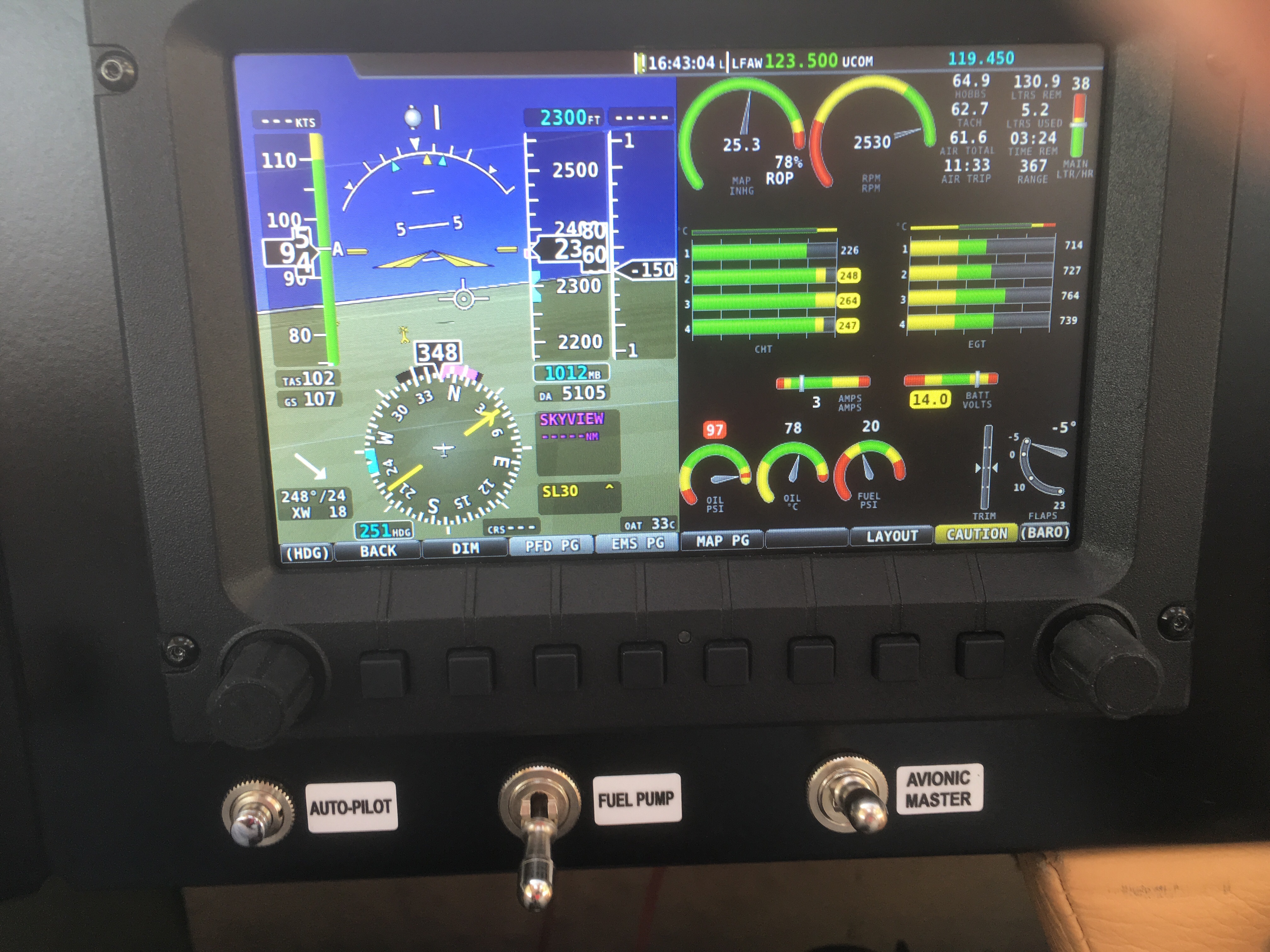

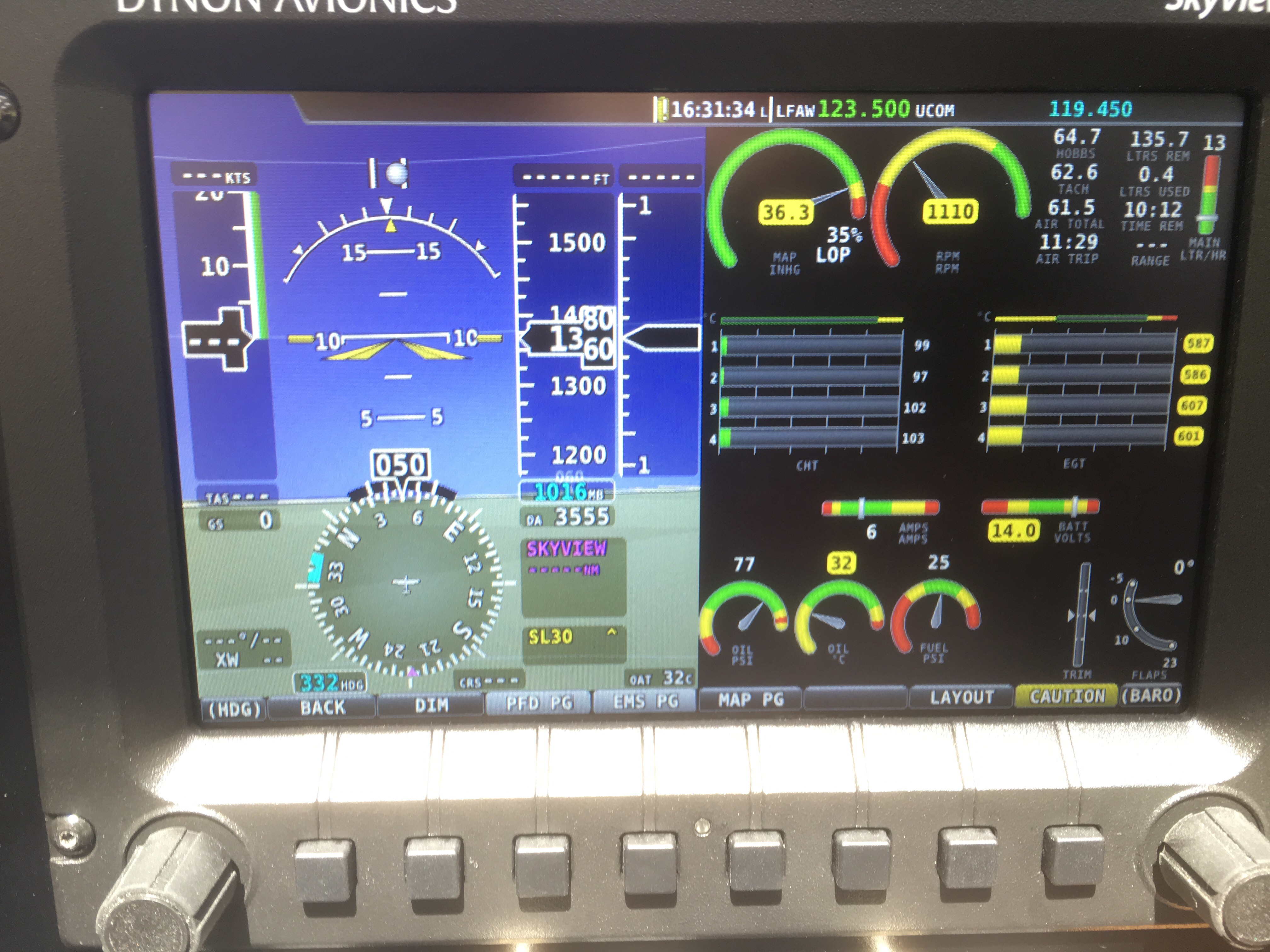

I took some photos from the debug screen. In between, I added a ground wire directly from the Dynon black ground at the probe to the battery and the engine. I can confirm that all probes are now very stable, including the MAP, but the oil pressure is still too high, showing 105 PSI instead of around 90 as the hydraulic analog instrument showed.
Here are the photos I took.
Do you think the configure file could be wrong or can we make an new one, adapted to my probe?
I will ask the engine maintenance workshop for the exact values noted at the last check with the analog instrument for each RPM (2000/2200/2300/2400).

So the characterization for that sensor is right. For the voltage that the sensor is outputting in that picture, you should indeed be seeing high nineties (for that particular picture). It looks like you have another 150psi sensor (the VDO style) in there for fuel. You said you've changed them to test, and the VDO also reads high. Is that correct? If so, does it read a similar value to the Kavlico? If it does, because those sensors work so differently, it's not likely that either SkyView or the sensor is faulty.

For the fuel pressure, I didn't change the probe. It is still the one which was delivered from Dynon with the EMS-D10 at least 6 years ago. The indicated values seem to be correct.
For the oil pressure, I had the one provided by Dynon with the EMS-D10 and due to the fact that indicated pressure was too high, I supposed that it was not reacting well with the Skyview. Therefore, I asked the french re-seller FinessMax to give me the one that they sell with the Skyview. The result is the same and nothing changed.
This STRONGLY indicates - because those sensors have different principles of operation and have different voltage output ranges - that the reading you're getting is correct.
