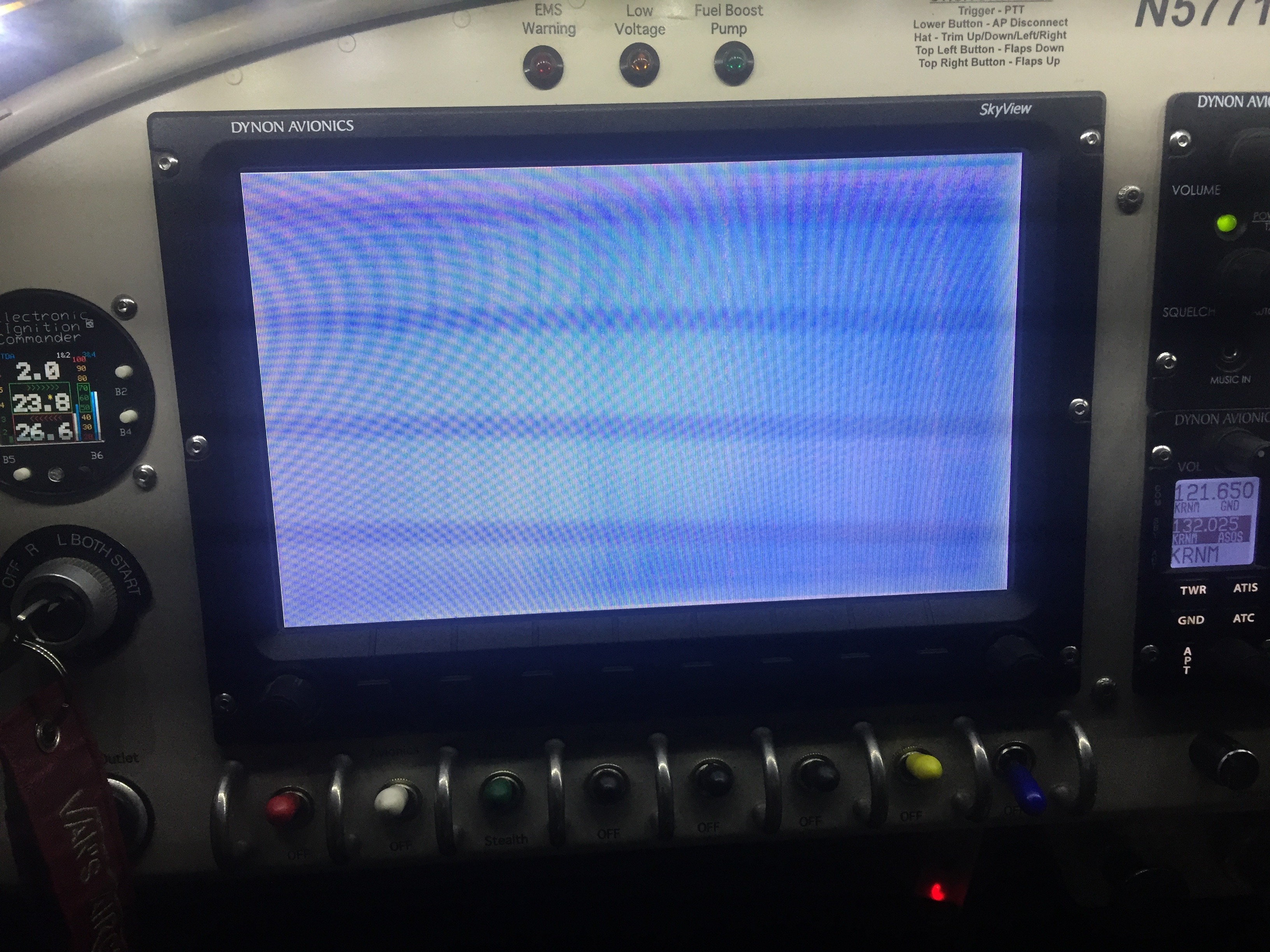

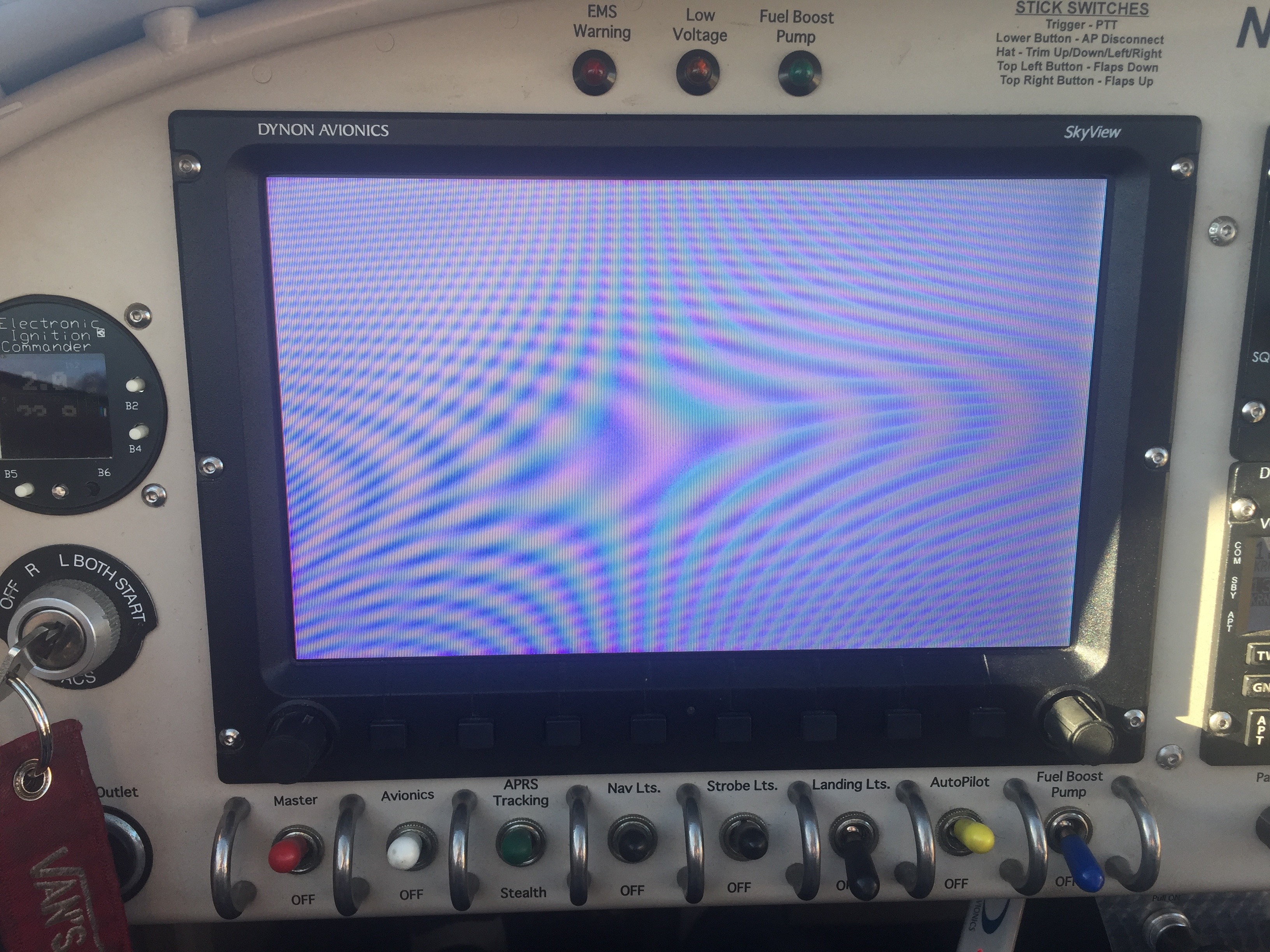

I have had this happen now a couple of times. Boot up the avionics. All is well. Taxi out and poof! The screen goes pink.
December 9, 2019:
January 1, 2020:
I am able to get it to come up correctly with a reboot attempt or two. Disconnecting and reconnecting the back up battery is sometimes also required to get it to do a hard reset.
I have the data logs and it doesn't seem to show anything unusual. It seems to happen when it is colder and the airplane has been sitting for a while (over a week for me). I live in SoCal, so "cold" to me is in the 40's.
Is this terminal and/or something that needs repair? I only have the one EFIS display, so encountering this in flight would not be good.

I did search the forums before posting this. I found another thread on the Pink Screen of Death symptoms. I'm not seeing any vertical stripes, just a pink screen. Sometimes there is also a bit of blue mixed in.
I've had this happen on boot up in the past. In those cases, cycling the power and rebooting would eventually clear it. Sometimes it would require me to unplug the backup battery. On those instances, I had parked the airplane (RV-9A) overnight in cool/wet/humid conditions. Not sure if the EFIS is just susceptible to being left out in the cold, since normally I'm hangared and in SoCal where the weather isn't much of an issue normally. The EFIS is not getting any direct moisture, nor do I have any canopy leaks (canopy cover keeps the rain out).
What is new is having it boot up normally and then just go "poof" with a pink screen on me while taxiing or in the run up area. Not a good feeling right before a flight.

I think it is time to make the call and send it in. I was going to do some pattern work today, but after repeated attempts at getting the Skyview display to come up, it never was able to. I get the verbal messages, so I know that the system should be up, but the screen is just a blue/pink mess.

Fast forward a month. I send Dynon the unit, pay the $450 flat rate fee for servicing, and they send back the unit. I plug it back in, and turn it on. Same issue. After several attempts, lo and behold, it displays just fine. Try it a couple of more times and it seems to be working again. I go and do a couple of laps in the pattern to warm up my oil for an oil change, and it seems to be working fine. Yesterday, after 2 weeks of sitting in my hangar, I decide to go knock around the pattern again, since I haven't flown since the oil change. I turn on the Skyview and after more than 20 attempts, the screen is still not working. This time it is just lots of pretty vertical lines.

The display issues have creeped up over time. Usually a reboot would eventually get it up and running. I noticed that cold/wet/humid weather also had some correlation. The wiring has been thoroughly checked. I did talk to the folks at Dynon today and they went over the prior RMA details. They did find a bad solder joint and replaced the LCD screen. They also did hot/cold soak testing before sending it back. It may just be infant mortality, or possibly a different hardware issue. Anyway, I hope this time it gets back to me as good as it was new! It has made me think that going to dual HDX just might be a good path. Having a single display is cutting into my flying time when it goes kaput. Now I just need to find the money!

Just a follow up. Dynon swapped out my EFIS with a newly refurbished unit (different serial number). I installed it and it seems to be working properly now!
