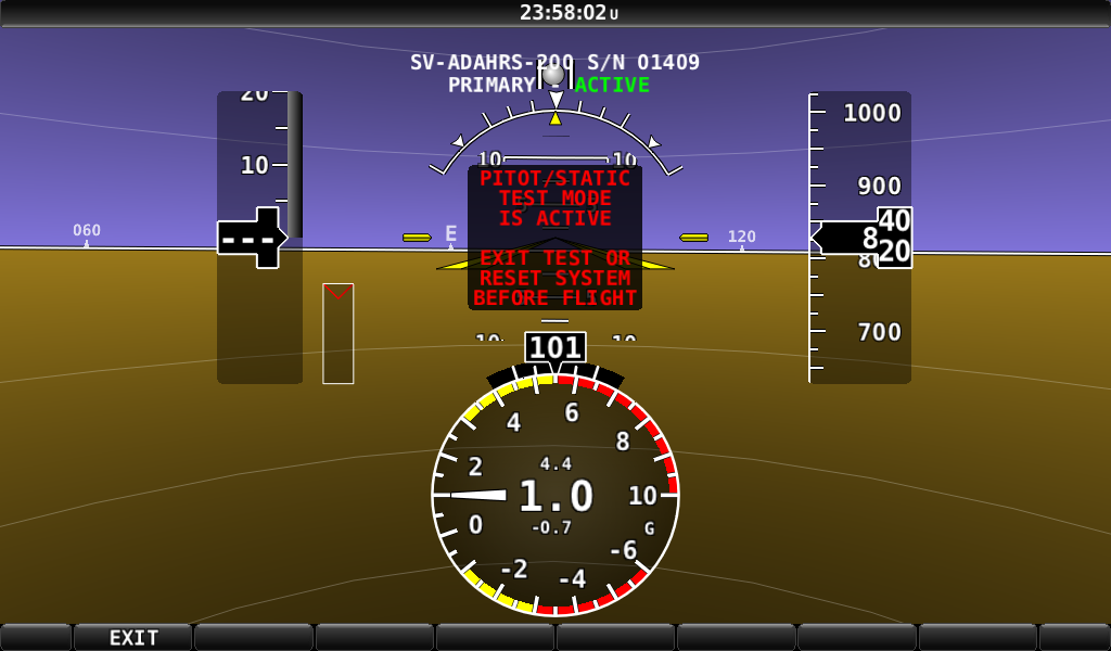

Its time for a pitot static check. What is the new procedure. Is it still required to power up at each point?

Implemented since last installation/pilot's guide updates.
From main menu on PFD
Hardware Calibration, then
ADAHRS Calibration, then
PITOT/STATIC TEST MODE, then press
TEST MODE
you will then see, the following:
