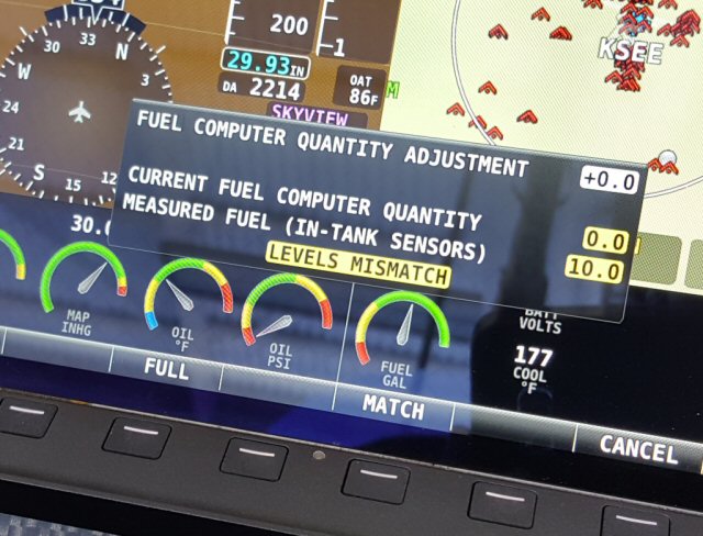

I recently hooked up and calibrated my fuel level sensor to the SkyView system. Fuel level works correctly but every time I turn on the display I get the attached error. I just click Cancel and everything is fine. How can I prevent this error message?

Do you have fuel flow? If not, you can turn this off in setup.
If you do, this is telling you to set the fuel computer correctly so it can track your fuel burn.

It turns out I had to turn off "fuel fill auto-detect" (or whatever it was called) in aircraft setup; it had nothing to do with fuel flow. Now the warning no longer appears.
