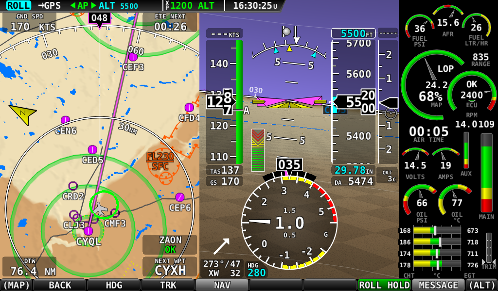

I just received my Skyview back from repairs. The settings were intact. On the first flight I had no HSI SRC's. I only have two. A GPS495 and the Dynon GPS. The only options in AP were HDG and TRK. The NAV was greyed out. No sources were showed on the PFD and I couldn't change the HSI SRC from the AP menu. The HSI SRC didn't show up on the PFD menu. The moving map was working and the magenta line from a DTO showed up on the map.
At my first stop I spent some time reviewing the menu's looking for a way to turn on the NAV sources and even checked my serial settings. Both the GPS495 and SKYVIEW were configured in the serial settings. On the way back (taxing), I switched off the G meter. It had been on since I reinstalled Skyview. Sometime after that I noticed I had my navigation sources were back. Both on the PFD and I could select NAV from the AP->ROLL menu. I switched the G meter back on but AP->ROLL->NAV remained available. Other than switching the G meter off, I don't believe I changed anything. I just went through all the menus looking for a solution.
I didn't try to duplicate the problem other than switching the G meter back on. Is this a feature or a bug?
