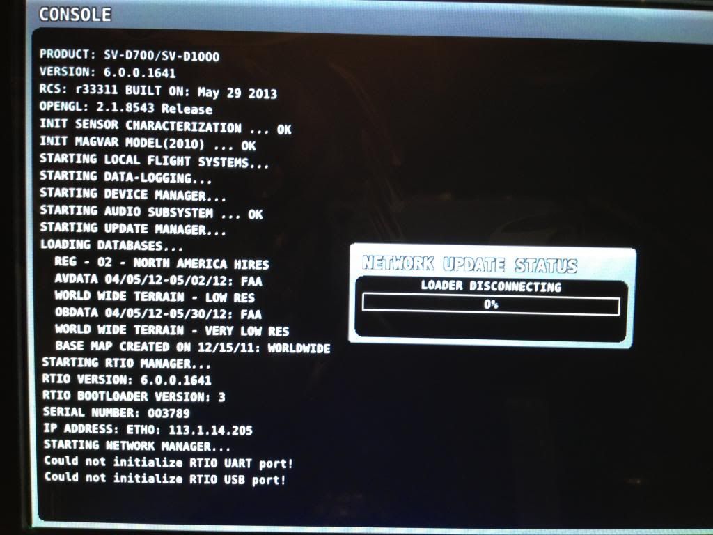

Hi, I tried to load 6.0 today.  I am upgrading from 3.3.2 and used Method 2 as directed.  Everything seemed to be going fine until the "Starting Network Manager..." as seen in the attached picture. Just prior to the "Network Update Status" dialog box with "Loader Disconnecting" as shown it said "Enumerating Network" and was stuck on 0% until the box came up as shown.  I let it sit this way for 15 minutes and then tried to recycle power but when I shut off the power it wouldn't power down until I disconnected the backup battery.  I turned the power on again and the same result even though let it try for about an hour until I turned the power off again.  What do I need to do?  I have dual SV1000 displays but did not attempt on the other one. I should mention that I am not flying yet and this week is the first power up and configuration of my Dynon system. Prior to trying to update to 6.0 I configured per the install manual which went fine. I did not try to configure the ADS-B 470 or my SV 261 Transponder. My system recognized the EMS and the network fine.

Hi,
Today I went out and powered up the system and the PFD came up.  Initially it showed the PFD screen but then changed to this view:

It looks like one of your displays has new firmware and the other old. Though it shouldn't make a difference, there's a possibility that for some reason this configuration is making your system behave the way it is. You might try upgrading the other display and see if that unsticks things.

Well, as I feared, I now have both displays doing exactly the same thing...the second display shows the same thing as my picture in post #1.
What do you suggest now?

We tried that this morning as I was talking with Mike. Prior to doing that one display has been booting up but the other was stuck at the screen posted below. After disconnecting the network and also the ethernet connection, both display booted up but only show the map and the red X over the EMS. After connecting back up the ethernet cable, neither display could recognize the other. So the plan is for me to connect one network module at a time to see what happens so that we might isolate it to a single module on the network. Mike said that he had seen something like my problem before but ultimately the displays had to be shipped in for repair. I am not able to work on this until tomorrow night so will post my findings later that evening.

Re: Problem loading 6.0---Solved!
