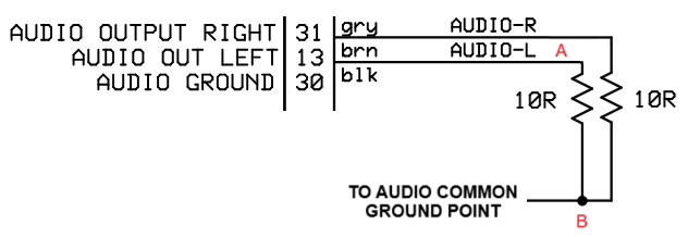

A solution to SkyView noise is to terminate the audio outputs of the EFIS with 10 ohm resistors to ground. This will attenuate both audio alerts and any noise, Then, increase the audio level in the SkyView settings.
Some of the of the noise that you are getting may be from the dimmer circuitry in the HDX, which changes with ambient light.
Here is my zero noise implementation:

Help me out here, Vern. Since I don't have knowledge of the AXIS-25A, are you saying to take audio out at point A or point B in the diagram below?
And since audio L and R are typically joined coming out of the Skyview, Couldn't you just use a single resistor?
You could use a single resistor to audio ground and tie Audio Out Left and Right together At point A. I show independent resistors for stereo intercom systems to support the possibility of future stereo warnings, like OnSpeed AOA systems use.

As a very much amateur avionics installer, I may yet need to use Vern's advice about resistor installation, if the hash recurs. I do not quite understand where the resistors go on the audio out wires. I have joined R and L audio outlets together ( mono to mixer) in, and the audio ground goes to the audio mixer gnd. If this hash reappears , where in the circuit do I place this resister as I believe the HDX mono audio signal still needs to input into the audio panel mixer.
Please pardon my naivety. I have looked at circuits drawn and can't work out where I would install the single resister if needed.
