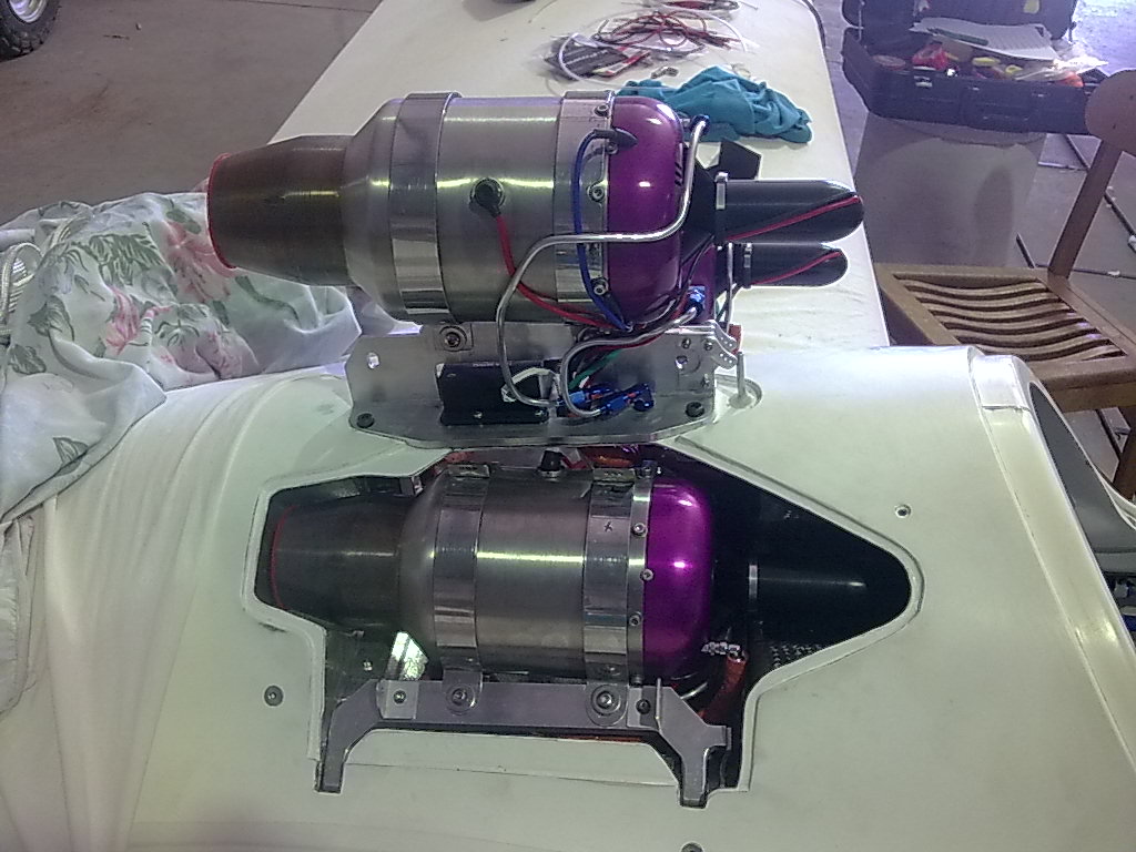

Well, it looks Australian to me, but that one only had two engines! This one looks much more complicated, and I can't recognize the glider with the little bit of it in the picture. Will it have SkyView in it?
2,232
Asw20 with 3x Amt jets, only one in existence I believe - a lot of wires for me to connect for such small engines. No Skyviews on this one but I am firing SVs on his Glasair super II RG as part of a complete install at the moment :)
