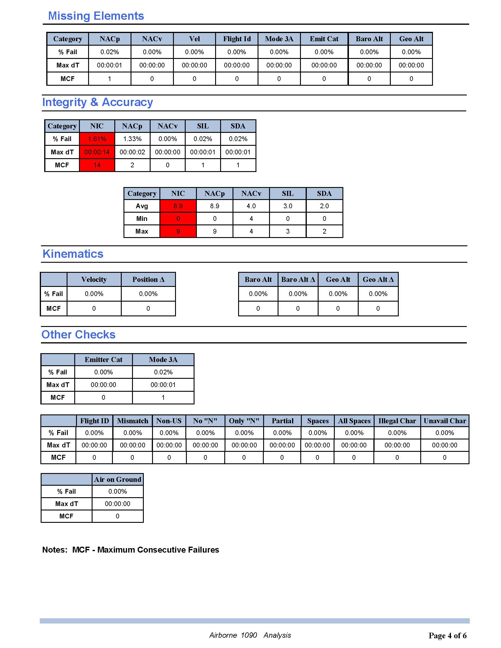

I sent in a request to the FAA for a report on my plane. I installed the GPS2020, have the latest software installed and I'm getting one error. The NIC column is red under Integrity & Accuracy. I get a % fail of 1.61%, a Max dT of 00:00:14, and an MFC of 14. Then in the second box NIC avg is 8.9, min 0 and max 9. I attached a JPG of the report. So what am I doing wrong?

Richard,
We've seen a few planes with that reported failure and have identified an issue in the transponder firmware. We're working on an update for that. Until then, there isn't anything you can do, but it also does not cause any operational problems.

Ok great, thanks so much for the quick response. I always think I'm doing something wrong. It's nice to get an answer.

I updated the software on the transponder and re applied for the FAA report. The red column under the NIC column is gone, but now I have red in the (Air on Ground ) column. I'm guessing I've got the switch to ALT not on AUTO but "ON". Would that do it? I've got to get back out to the airport to check it out. I won't be able to till the weekend.
Yes, that would do it ;)
rfazio1951
Feb 11, 2010
361
I am happy to report that I set the transponder mode to auto for ALT, GRND, and I now get a perfect report from the FAA.
