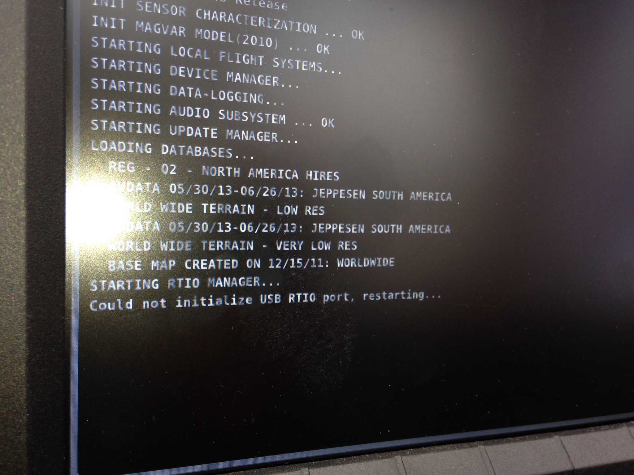

I need a little help,
Today when i went to fly, my RH side screen didn't boot up, it started all that initial process normally ( with Dynon logo screen and all that informations, computer type fonts etc) , but screen didn't move forward, it didn't started the normally, instead, it started all over again, and over and over. I pulled the breaks, did all resets and nothing...
I noted a msg at the initial black screen, after the logo initial screen:
Could not initialize USB RTIO port, restarting...
Your thoughts would be very helpful
Thanks
Mauricio
Mauricio - it sounds like a failure of the display. Please contact our technical support staff directly at 425-402-0433 or support at dynonavionics dot com for further help with this issue.
