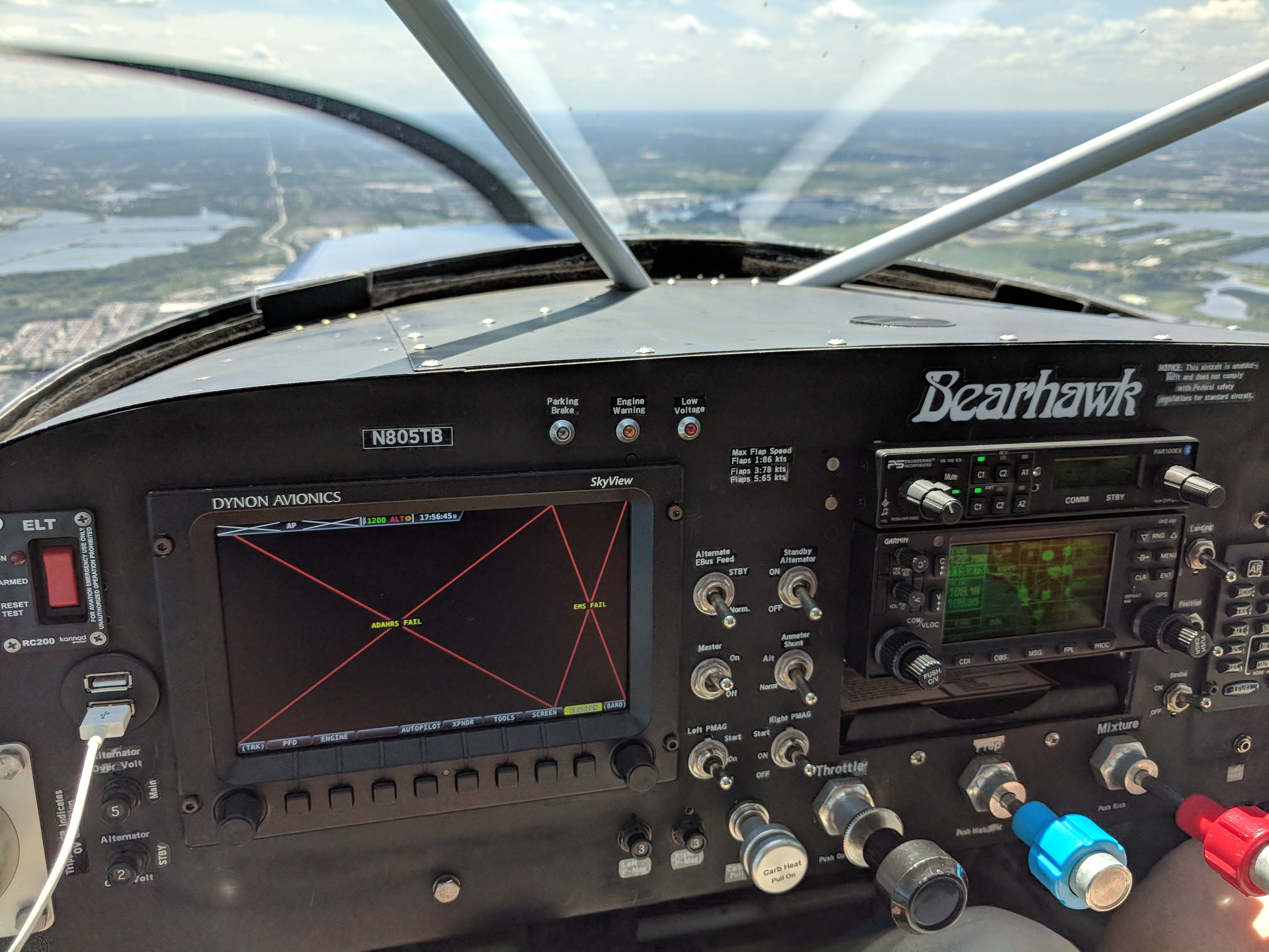

Coming home from Oshkosh just south of downtown Chicago, my left screen went to all red Xs. After landing I removed bus power. The other screen powered down normally after 30 seconds. The bad screen stayed on, so I held buttons 1, 2, and 5. That shut it down. On reboot everything was normal. I'd sure like to understand why it did this. Do we have any diagnostic capability?

As the Transponder was still showing it looks like you possibly lost the network connection to the left screen ? Did you check that ?
Yes, there is a diagnostic log capability. Please give our support team an email or call at 425-402-0433 or at support at dynonavionics dot com so that we can help you further with figuring out what is going on here.
