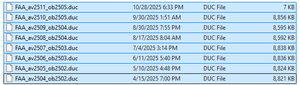

I recently have problems while updating my charts on my SkyView HDX system with Seattle Avionics. SkyView's displays an error when I try to load the November 2025 data. It says that it can't read the USB drive, however, prior updates still load correctly. There seems to be an error with the recent file I got from ChartData. I'm almost certain the updated data is not only 7 KB when all prior updates have been over 8,000 KB (see the attached screen shot).

For one thing, the current cycle is av2511_ob2506. Not 2505. For another, these are Dynon files, not Seattle Avionics data.
Much as I hate SA's app, this looks more like you messed up the download of the current Dynon .duc file.

I had the same issue, and another local pilot did as well. Seattle Avionics will now download the Dynon database onto your USB stick as well as your normal subscription - but this latest cycle it was corrupted. If you'll download that file direct from Dynons site it will work fine.

Yep. Just checked the downloaded files on my computer, and it's both old and waaaaaaay too small. Current version is
FAA_av2511_ob2506.duc
8.65 MB
The SA downloaded version is
FAA_av2511_ob2505.duc
6.36 KB
