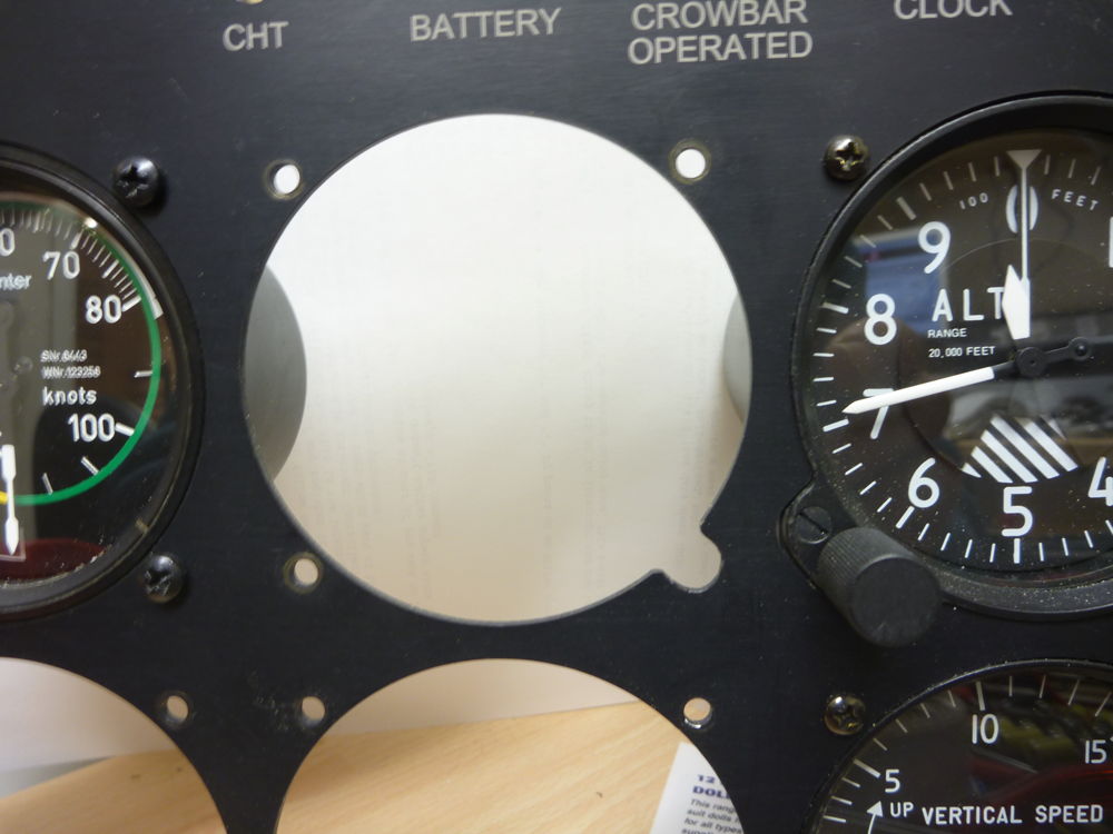

Bebo - thanks, that is helpful! Looks, though, as if you have a bit more space between the instruments than me. Here attached is a picture of the relevant part of my panel.
in friendship
Rowland

I must check without D2, but it seems you are right, I've more space.
My plane is about 5 minutes from home, no problem to make other photos if you need.
