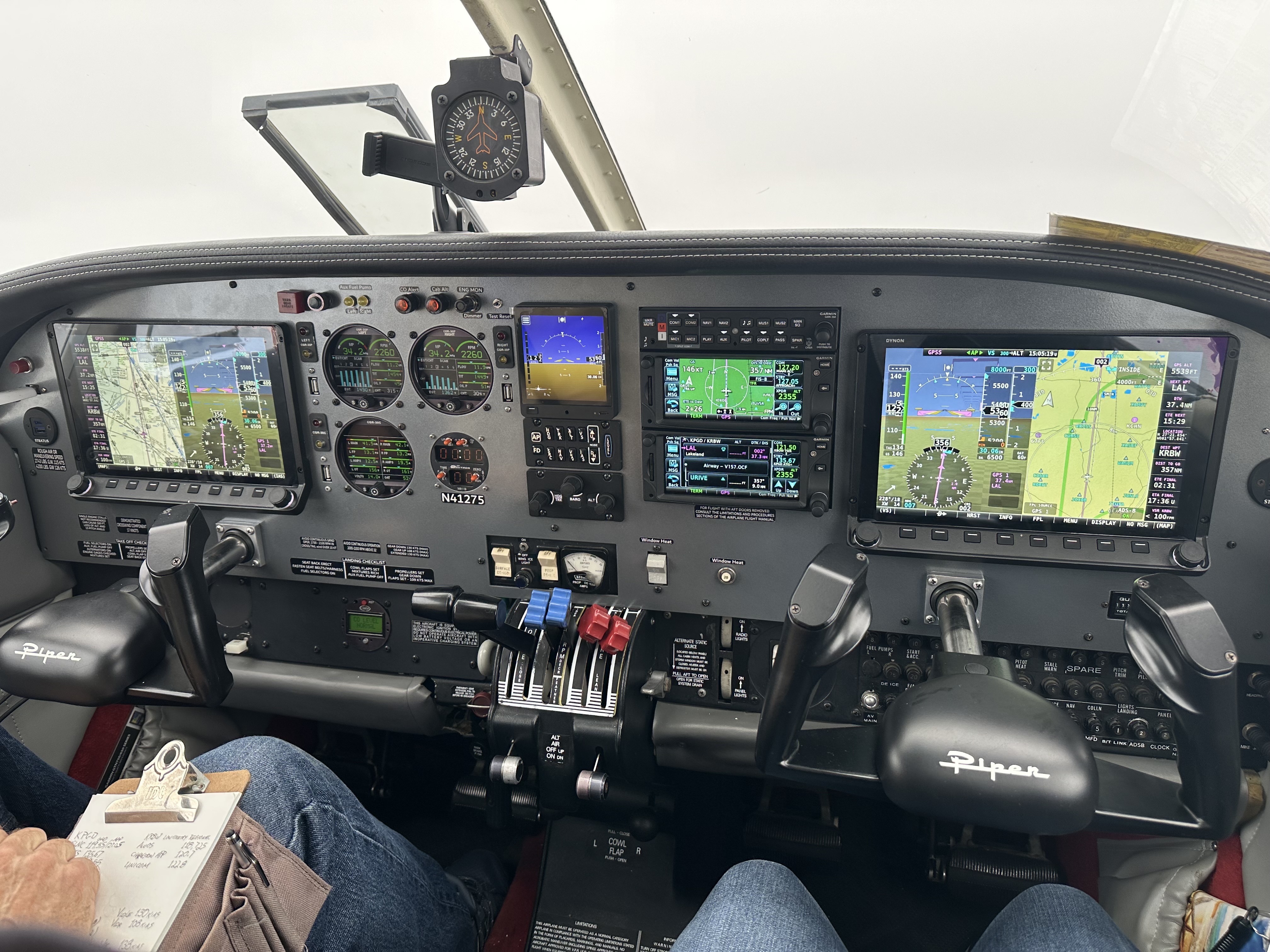

I recently completed a senneca 2 installation . I was along a a few test flights with the owner and found the autopilot did a fine jobs in mild to moderate bumps . I did not feel the yaw tendency was as pronounced as a Beechcraft would be . I would suggest a few trips with your yaw damper disengaged and see if your passengers notice or say anything . You should be able to cruise high enough to get clear of the bumps on most flights anyway .

We installed Dynon displays and autopilot in our Seneca II about a year ago. At the time, my biggest complaint was that the autopilot was not self trimming. When I enquired about that being corrected, I got an answer quite similar to the response you received regarding the yaw damper. Early this year, they added a trim amp servo that allows the autopilot to trim in pitch.
We’re very pleased with the Dynon operation and the autopilot has worked very well. The ride has been great and we haven’t experienced any issues with Dutch roll.
All that said, we’d like to see Dynon make this autopilot as fully capable as anything on the market. If and when they get a yaw damper, we’ll be at the front of the line to buy it, just as we were with the auto trim capability.

Thank you so much for the reply! Very nice panel. Would you mind answering a few questions for me?
1. Is there a reason you are using the CGR-30P engine monitors as opposed to the Dynon? I'm guessing you already had them installed before the Dynon.
2. Can you confirm for me, the autopilot only captures the GS from below?
I'm about 98.8% sure I'm going with Dynon, especially after the EYE WATERING quotes from Brand G with the GFC 500 o_O
Thanks again! Seems more and more Seneca drivers are going Dynon!

The aircraft came with the CGR-30 setup and the Garmin radio stack (350 audio, dual GTN-650s, and a 345R transponder w/ADS-B in/out).
All that was working great and we elected to keep that equipment. It all works very seamlessly with the Dynon panel and auto pilot. Obviously the CGR-30s are stand alone and do not display on the HDX, but I prefer it that way.
The Dynon Pilot’s User Guide states that the autopilot only captures the glide slope from below. I’ve never attempted to test that, but I have no reason to doubt that.
I’m very comfortable flying approaches to minimums with the autopilot coupled and clicking it off when we break out. Likewise, hitting the UP button gets a miss started nicely.
If you do choose Dynon, I think you’ll be very pleased with the results.
