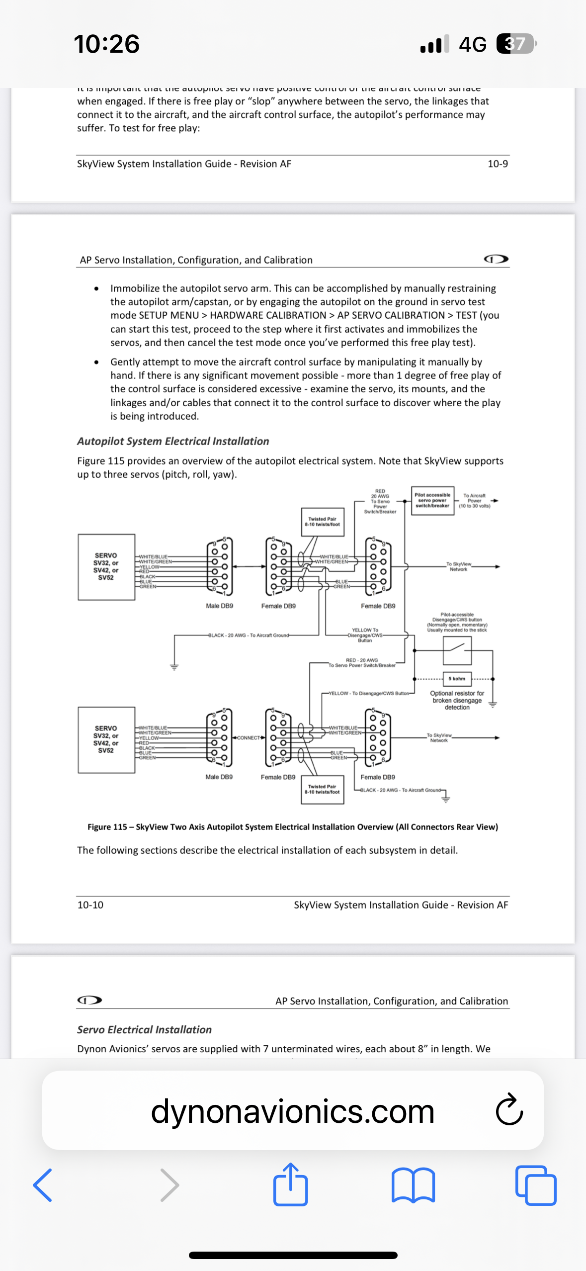

I had a strange problem after adding my remote magnetometer. My servos would not go offline, but I could not engage the AP. I had to remove the yellow wire from the d-sub that goes into the magnetometer. Problem solved.
Some details about my install… I added a hub out in the wing so I would not have to run two long network cables as my conduit was full and could not accommodate the second network cable. That said, I route a network “trunk” from behind the panel, out in the wing through the conduit to a hub mounted on a rib. Then route from the hub to the servo and to the remote magnetometer out in the wingtip.
2,251
The A/pilot CABLE IS DIFFERENT to the standard network cable for a reason. The network wires ie pins 1&6 + 4&8 are the network wires common to all the other network wires needed for the system to ‘see’ the other network items. Grounds (I allocate to pin 2) & power (pin 2) are 20 awg with ground going to a local point & power going to its own breaker/s. The Yellow ( pin 3 is my choice) goes to a/p disconnect switch & that’s it. Read the Manual - it has a diagram too😉.

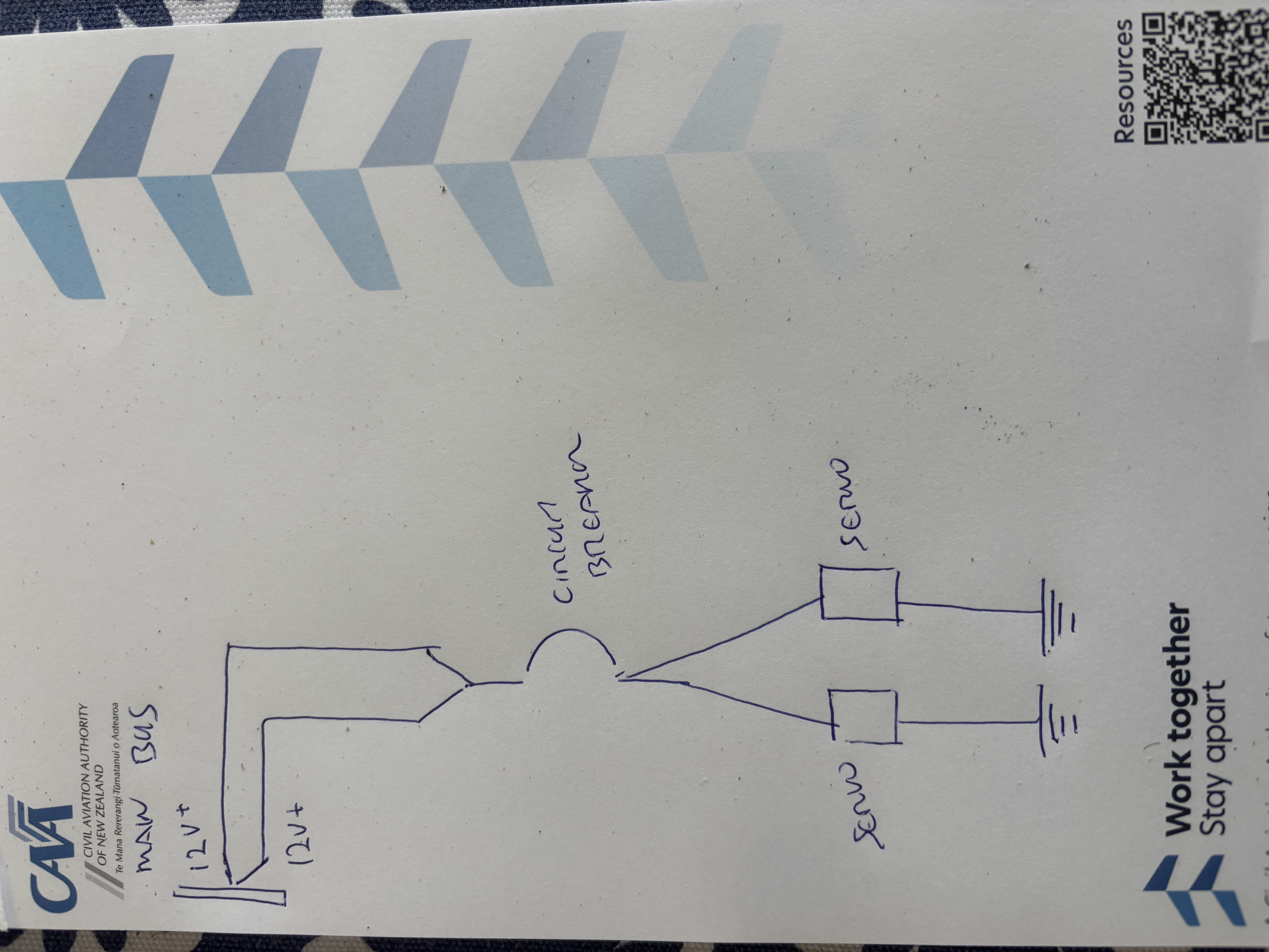

Hi everyone
I have a Skyview HDX with autopilot, operational in my aircraft for about 190hrs and 18 months. I’ve really been enjoying it.
Recently though I’ve found that my servos are going offline. I get a aural “Message” warning, with the word “message” being momentarily displayed, but when going to the message there is no message there, except a couple of times I’ve been fast enough on the button to open the message “Pitch servo offline” together with “roll servo offline.”
At the same time flashing very briefly in the autopilot task bar I get the two white crosses indicating that the servos have gone offline. However it is always only momentary, literally the blink of an eye and I don’t always see it. The white crosses never remain as they do when I power the servos down by pulling the breaker.
If the AP is engaged it disconnects.
I’ve read every relevant thread I can find and looking at the user guide this message is supposed to indicate loss of power to the relevant servo. Power to my servos comes from a 5 amp breaker. From this breaker each servo is ”fed” with a separate wire. Likewise each servo has a separate earth. So I’m reasonably confident it’s not a continuity problem there. I’d initially suspected that it might be transponder interference I’d read about, but the data and power wires are down one side of the airframe and the antenna wires the other side.
The antenna is about 30 inches from the servos, and in any case it all worked flawlessly for quite some time, and flight testing with the Tx off I still intermittently have the scenario described above.
The two servos plug into a hub adjacent, with a network cable going forward.
Is there a possible failure mode in the breaker (Klixon) that results in a fleeting interruption of the power supply? (Will swap it out as soon as a replacement arrives.)
Something wrong with the network cable exiting the hub maybe but this hub also has remote magnetometer plugged in and I’ve never had an indication of a problem there.
Is it possibly a software thing?
Any thoughts greatly appreciated.
Thanks
Peter
I had this same issue last year. Everyone here was so helpful. I just could not find the source of this power loss. I even sent both servos back to Dynon, where they were run for a few days, and returned to me in normal working condition. The HDX menus did not find either servo (like they were never installed). I even had a VERY skilled avionics guy take a look, and we could not find the power loss source. I think someone here made this suggestion... run a new power line from each servo directly to another power source... and voila! Both worked (i was already depressed that I'd have to remove the interior/floor and retrace each damned wire). So, started fiddling behind the C/B panel... nothing. Changed out the Klixon C/B to a new one... nothing. Then redid the ring terminals and attached them to another source (different C/B) on the bus. And bingo... they worked! Either the old ring terminals or something in/around that C/B was/were goofy.
Try the 'jerry rig' with separate wiring. What a struggle this was. Working perfectly since.
