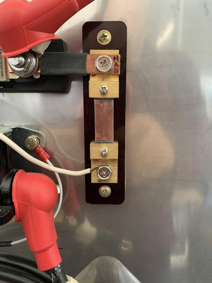

I have had the Dynon 60 amp shunt break around the mounting holes twice in 330 hours. It is attached to the fire wall high on the right of my RV10. I was especially careful about mounting it the second time to make sure there was no extra pressure on it. This time I got a friend with an end mill to make me a replacement part to mount the metal part on out of Delrin. It is a solid piece with holes in all the right places to mount the metal piece and properly countersunk. Hopefully this is the last time I have to fix it. It sure is mounted much more solidly than the hard plastic piece it used to be mounted on.
The shunt mounting fasteners should be slightly smaller than the mounting holes in the shunt allow, so that any flexing of the airframe its attached to isn't trying to snap off the shunt mounting ears. Next size down screws with some heat shrink tubing to center the screws and nylon washers above and below the mounting ears so the shunt can float a little. There's no mass there, so you don't need a pair of 1/4" bolts to hold it down. Maybe a better solution than changing the shunt base to Delrin would be to attach a new shunt to an aluminum plate (rigid block). That would transfer the physical loads to the plate and keep the mounting screws from trying to snap the mounting holes out.
The concern I would have with changing the base material of the shunt is that the original base was very rigid (brittle) by design. This held the terminal posts and the shunt element in a very rigid physical position with relation to each other. The whole shunt moves as one piece. This keeps the shunt components isolated from twisting or pulling against each other regardless of what the material the base is attached to does. There are lots of insulator material choices for manufacturers to choose from. Invariably they choose Bakelite or some other very stiff material, I don't think that's an accident.
Changing the base to Delrin, which is more flexible, solves one problem and I suspect will ultimately create another. The shunt element is rigidly attached to the terminal posts which are now attached to the vibrating airframe by a flexible material. As a consequence the vibration is now flexing the shunt element (probably concentrated at the points where the thin element attaches to the terminal posts). I think at some time in the future the point where that flexing is happening is going to work harden enough and fracture. As the fracture progresses, the resistance of the shunt will change and the ammeter reading will become inaccurate (read higher than the current passing through it actually is). The remaining material will also heat up by resistance heating as more current passes through a smaller cross sectional area. That heating will accelerate the hardening and the rate the fracture it moving. Depending on how the meter is in the circuit, as a "Load Meter" or "Charge Meter", a failure of the charging system or complete failure of the electrical system will happen (probably on short final at night in IMC).
