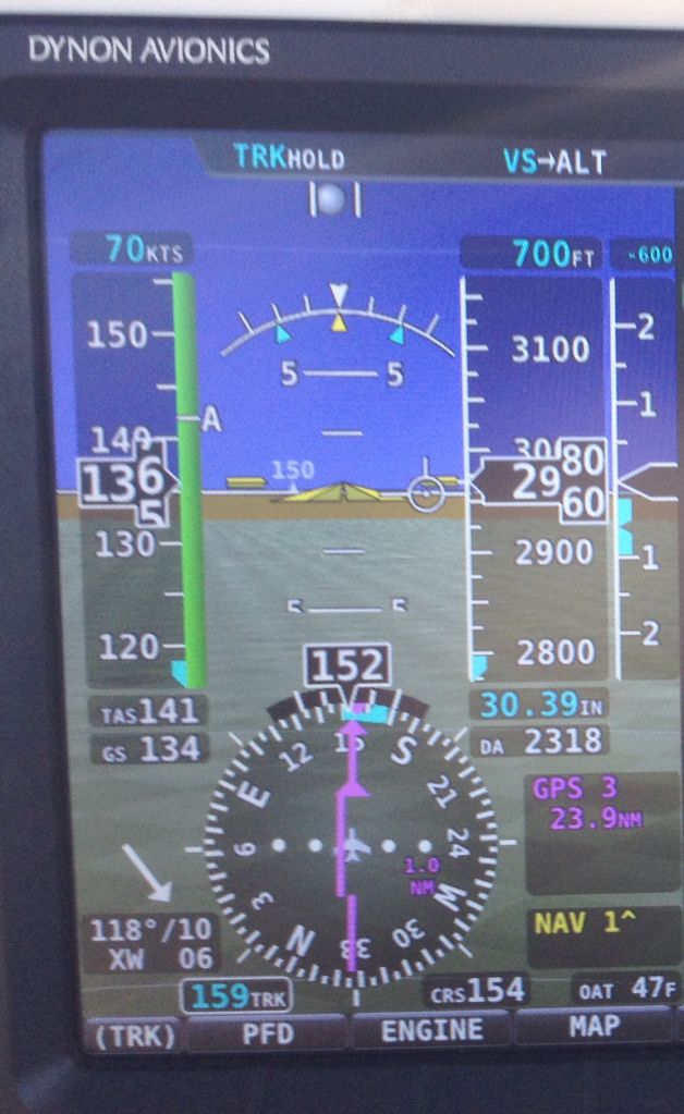

Interesting thread. This how mine is straight and level:
My D6 backup is centered. Wish there was a way to adjust.

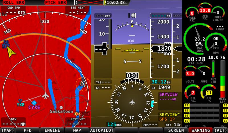

Depends if the plane (ADAHRS) is level. Here's one showing it off to the right. The next picture is in flight with everything nearly centered.

I agree. The first screen shot was to demonstrate for Elmer that the skid ball can be off to the right contrary to his theory. The skid ball is probably off to the left in the majority of screen shots because the builder is sitting in the left seat when the screen shot is taken.
The second picture definitely shows the ADAHRS is installed correctly and what a person should be looking for in straight and level flight with no crosswind.
