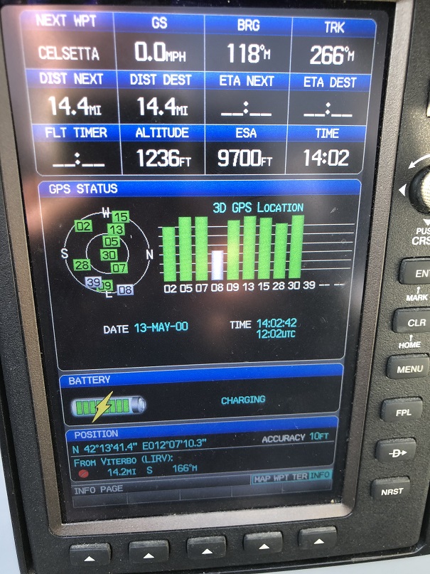

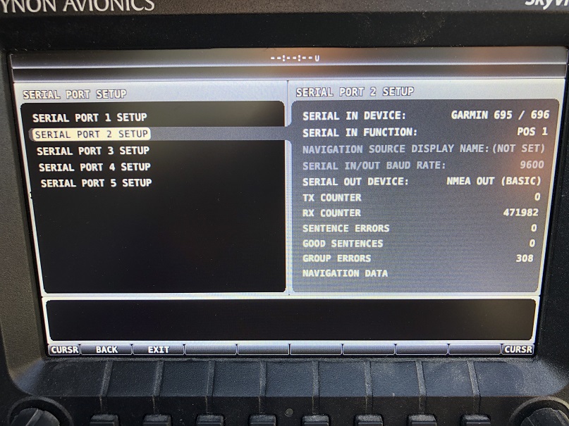

Hallo. I am testing my new RV4 and I can't set the hour on my Skyview since the Garmin 695 signal doesn't arrive to Skyview.
It is connected to the serial port.
I reset all serial ports and left only the serial port #2 for the 695.
Garmin acquires satellites, SV has RX IN counting, but the GPS input doesn't arrive.
What was my mistake?
695 has been set to transmit AVIATON IN + NMEA OUT and FAST.
Thanks.
Camillo
P.S.: does anybody know how to set time manually, i.e.: w/o a GPS input?

Problem solved. I had to set Garmin for NMEA OUT and 4800 baud rate. It works, now.
BTW, it's not possible to set the time w/o a GPS signal...
