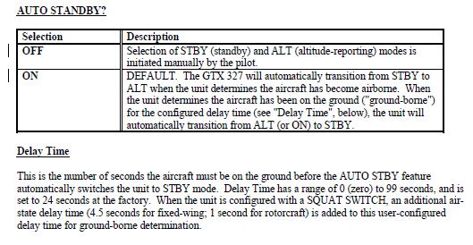

Is it rapid changes in altitude or does it pick out airspeed from the NMEA stream? My GTX327 didn't switch to ALT until I upgraded to firmware 2.1. I have the second serial port RX of the GTX327 connected to my GPS495 TX which outputs NMEA and VHF data.
From the GTX327 Manual:
Also under "3.3.7 AIRCRAFT TYPE"
There is no discussion of rapid changes to altitude, just "time to STBY, required airspeed, ground speed".
