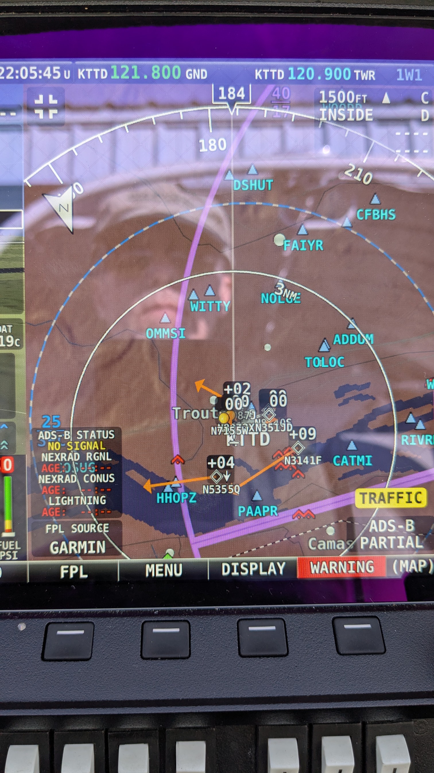

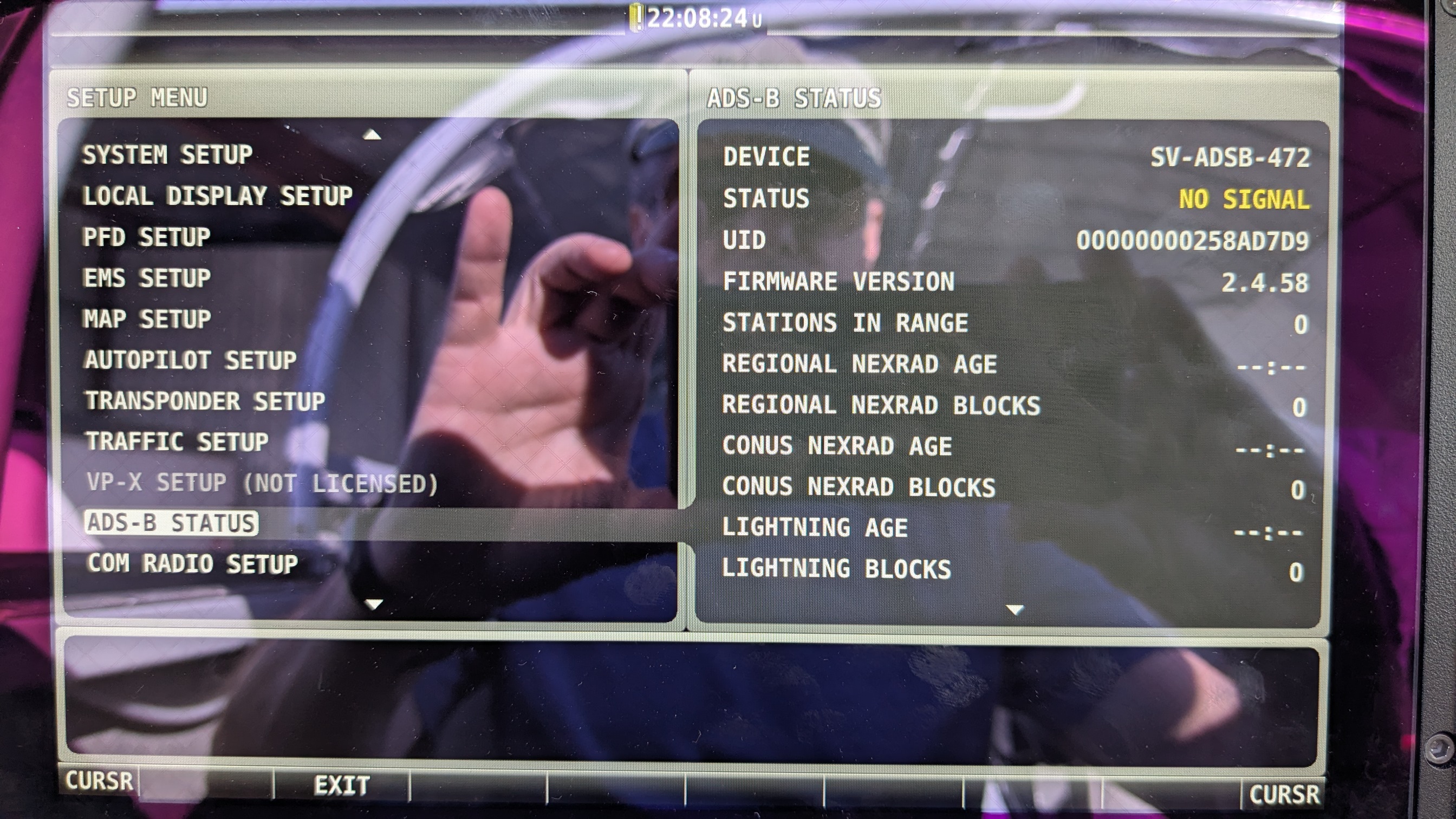

Recently I have the "ADS-B Status No Signal" and "ADSB Partial" messages
on my map screen. Included are some screen shots of my system. The system shows other traffic OK, and my aircraft is shown on flight trackers OK. I cannot receive ADS-B weather and other data however.
Dynon tech support believes it might be due to a short low altitude flight that caused the ADS-B Partial which can be normal. I won't fly this airplane for a few more weeks so I'll see what happens then and report back here.
