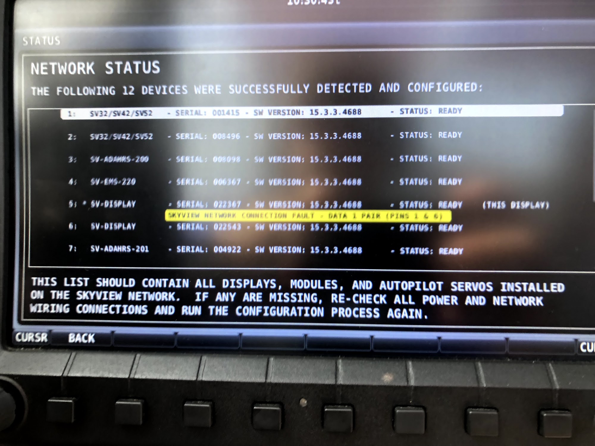

Need help with Skyview Network Connection Fault - DATA PAIR (Pins 1 & 6) error. This system has been functioning perfectly for about 18 months. Also, all of a sudden I get a fuel warning for 00 fuel in both tanks. Both gauges go to 00 for about a second and then go right back up to the correct level. It has done this on the last two flights at about the same time. Any ideas on where to start troubleshooting would be appreciated! As you can see in the photo, I have a full install of 12 devices, 2 servos, ems, dual adhrs, adsb, etc...

I’d check it out by a process of elimination, unplug 1 x SV device at a time to find out which cable network is at fault & then do a continuity check of pins 1 & 6 (Green& Blue wires) & also check that those pins are locked in place by giving a gentle pull on them :)

Thanks jakej, I will plan to try that this weekend. Any idea if the issue with my fuel gauges could be related??
