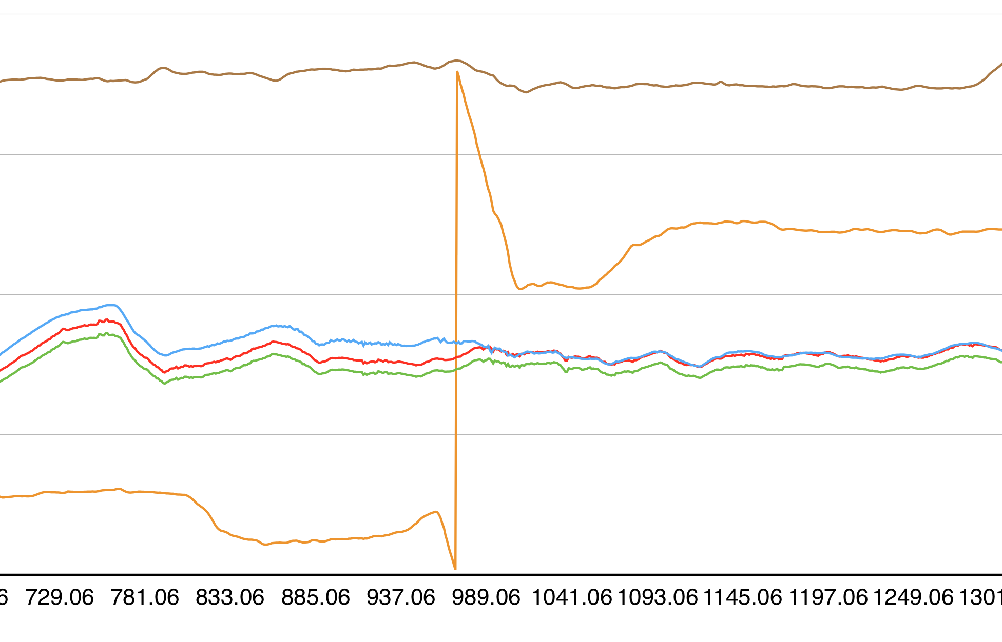

We flew the airplane in close formation with another. Our altimeter readings were within 50 feet of each other.
Still on opposing headings within minutes I get the following readings for GPS ground speed (in blue), TAS (in red), IAS (in green). Alt/10 is the brown trace and heading the orange trace. I know I should be happy that I never have a headwind.  ;D
