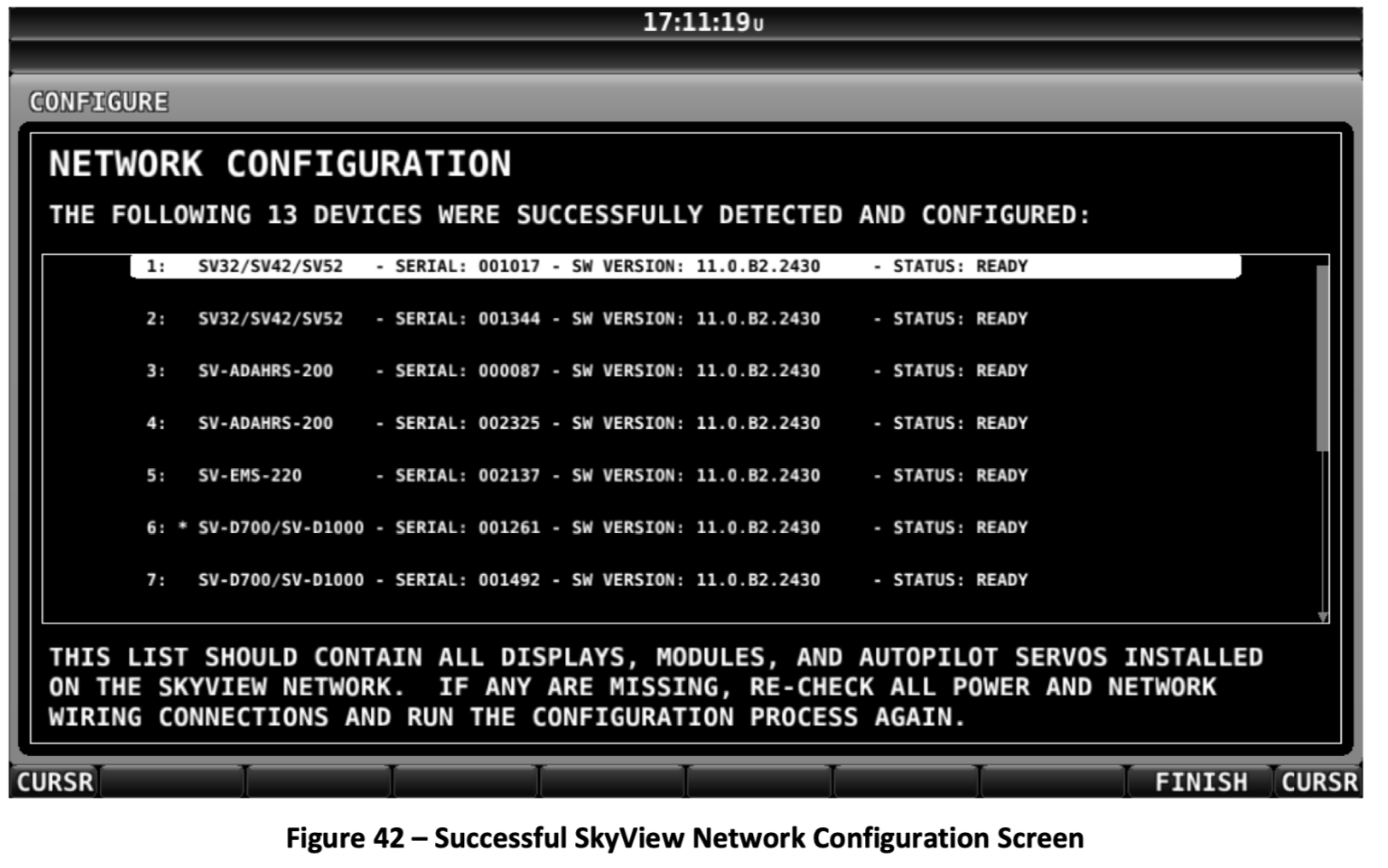

Was it visible in your installation before? Did you do something to it recently? When you go to
<SETUP MENU > SYSTEM SETUP > SKYVIEW NETWORK SETUP > CONFIGURE…> does the com panel appear in the network list?
