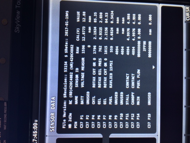

Just finished building an RV-12. During engine runs I notice I'm not getting a fuel flow reading. I've verified the FT-60 red cube is properly installed and receiving 12vdc power. Not sure how to test the collector output. When I review sensor data off the Skyview I have no values for fuel flow...see attached file.
Any ideas? The troubleshooting I did today was with the fuel pump running and fuel circulating, engine off.

Jim,
Take the sense wire (white, I think) at the cube at tap it against a ground. This input senses something that is either ground or not. When you tap it, you should see a fuel flow. If you do, then the sensor is at question, if you don't, then the wiring or EMS is an issue.
