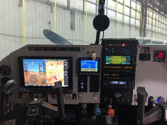

I'm not waiting - upgrade almost done. Everything was pre-wired for the autopilot and the panel was cut for the control head with a Dynon blanking plate installed for now. Hurry up, Dynon! Many of us Mooney guys are doing good advertising for you, now help us help you.

What a beautiful panel. Question: Is it at all possible to put a smaller 7” display on the right side of the panel? The panel seems to be canted towards the pilot which makes me think it’s impossible but I’m not 100% sure. Do you happen to know the answer?

The space on the right of the radio stack is 6.375" wide and the Dynon 7" display needs 7.5" space. It's possible to fit the 7" screen but it means the tach and MP gauge need to go away and a new panel for the breakers needs to be fabricated. You can kinda see the issue in the picture below. I am going to install a 7" Dynon to display the EMS when I install the Dynon autopilot. Re-doing the panels on the right will be expensive but I think it will be worth it to get a dedicate EMS display and get a back-up display for the 10" display in the process. I can fly without an autopilot for a while and the Dynon autopilot is supposed to be a fantastic unit so probably worth the wait. I'll post more info after I pick up the plane and have it flying for a while.

That would be my idea is just 86 the tach and MP gauge since the HDX can include an EMS. But my question is, can that canted portion of the panel be straightened out to be straight like that 6.375” part of the panel? Is there a rack or vertical piece of metal on the seem where those two pieces come together? Are you sure you’ll be able to put that second 7” screen on the right side of your 231 when you take it back?

Since that section was the second radio rack, there were rails there that the radio trays were riveted to. Now it's just the flat panel and I don't know how the shop did the connections, I suspect they just kept the rails in place and screwed the panel to the rails. The angled panel where the MP, tach and breakers are is a single piece (actually a large try) and it will require considerable re-work to make a portion of it flat. I am NOT sure that it can be done but will certainly try when we're ready to install the AP. Fall back will be to install a JPI 930 which is about 6" wide and will fit into the space.

Ok, I see. So right now the idea of putting a second screen on the right is theoretical basically. I really hope it can be done because it would be nice to have the space to put that 7” screen so you can display the EMS screen or moving map without crowding the PFD screen in front of you,
