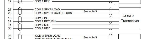

Com #2 phones low should go to pin 14 of J1, not the ground loop
COM#2 Phones Hi - Pin 13
COM#2 Phones Lo - Pin 14

GKC Aviation. Can you provide me with the pin numbers and names on the COM 2 Transceiver Block and make them in reference to the SV-COM-T25? I am getting a little confused with the naming/function of each pin based on the documentation that I have.
Thank you...
Alex
GKC Aviation
Oct 4, 2020
170
Hi Alex
COM-T25 pin 2 (phones out) goes to GMA340 pin 13 of the J1 connector
COM-T25 pin 1 (phones ground) goes to GMA340 pin 14 of the J1 connector
