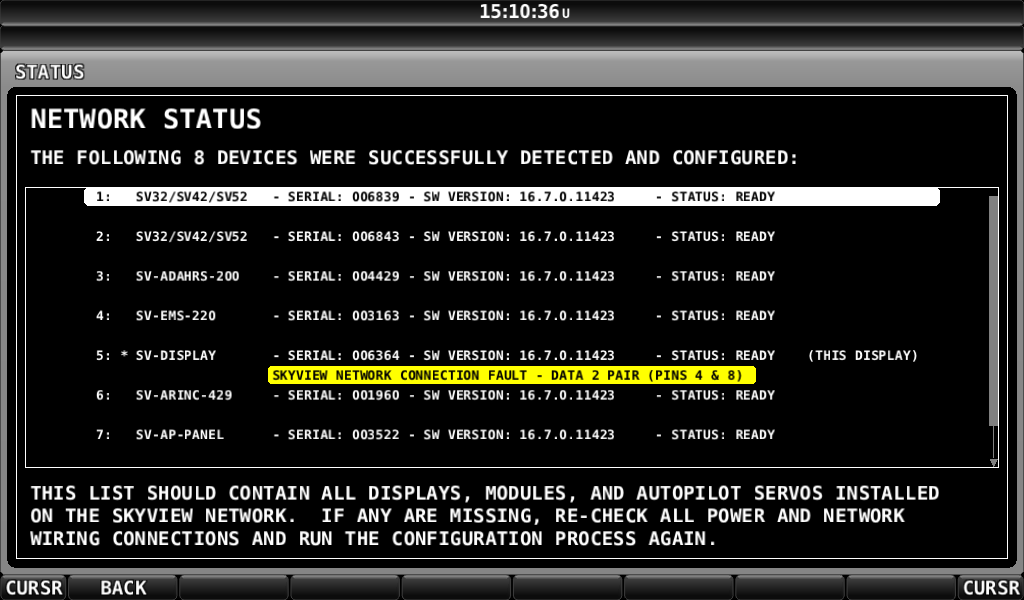

Went to fly today and got a CAUTION message for a secondary network fault. Checking the network status page shows the D1000 display has the fault listed. Troubleshooting steps:

Quick update after 3 additional flights with a secondary network error cautions. Looking at the alert data log for each flight the secondary network caution showed at 14 minutes after D1000 startup on 2 flights and 12 minutes on the third. That pattern is typically associated with a heat failure of an electronic component. The last flight included an EMS Fail that lasted 1 second (flashed the red X on the EMS display) and recorded 3 instances of KNOB PANEL OFFLINE alerts that lasted for 1 second each. That is the first time I have ever seen a Knob Panel Offline alert in the log.

Just wanted to close out this thread with the final resolution for the secondary network error Caution I was getting on my SV-D1000.
Working with Dynon tech support, extensive configuration testing was completed using both a newly fabricated EMS cable and a Dynon supplied test cable. Getting the system configuration down to just the D1000 and only one other SV device at a time, like the EMS, the D1000 always showed the secondary network fault. The configuration changes included testing with a new SV Hub and wiring the EMS directly to the second D1000 SV Network port (SV hub was on the other port). I also upgraded to software ver 16.7.4 as a final troubleshooting step. After several additional flights, including one where both the primary and secondary network failed (no EMS data or ADAHRS data), the D1000 and EMS were returned to Dynon for repair.
One note about the inflight primary and secondary network failure, after flying several minutes with no EMS and no PFD it was apparent the D1000 was not locked up, so I did a Button 1 power down and restart. Upon rebooting the D1000 was operating normally (still had the secondary network error) until I landed about 45 minutes later. I did get a SE21 on a previous flight where the D1000 had auto-rebooted during flight and ran fine for another hour after that before landing.
One month and $1,100 later, the D1000 has been repaired and returned. I asked what was repaired and did not receive a response other than “mechanical/electrical component failure”. The EMS-220 only received a “functional test”, which I presume means it was working with no issues observed or repairs required.
