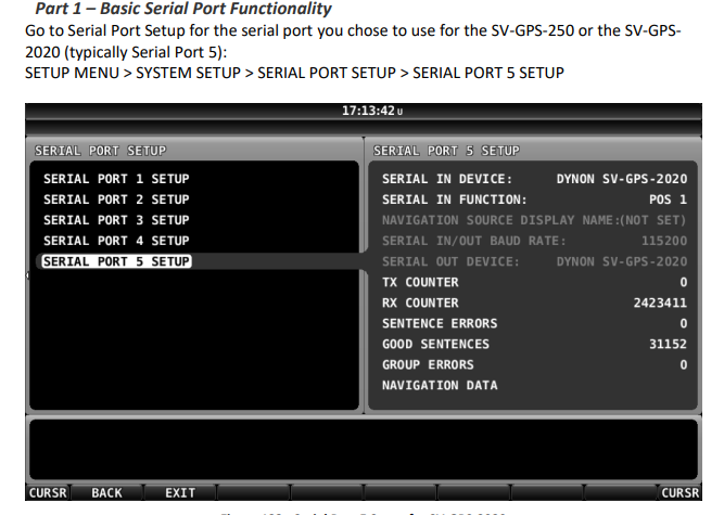

I'm in the hangar (no satellites are visible). How can I tell if my SV-GPS-2020 is communicating on the network? The SV-GPS-2020 does not appear in the list of detected devices (but there is a disclaimer about the SV-GPS-245). I was looking for a screen that might say something like "searching for satellites"?

You can also go to Setup > Local Display Setup > GPS Fix Status and see its status, even if it doesn't have satellites

Thanks very much, Glenn. I can see the RX and Good Sentences counters incrementing. That convinces me that the SV-GPS-2020 is "online".

In the configuration menu under Local Display Setup there is a GPS fix status. Shows fix quality information for the GPS source that is being used as the active position source for SkyView’s moving map and synthetic vision, according to the installation manual section 3. Basic SkyView Display Operation .....
