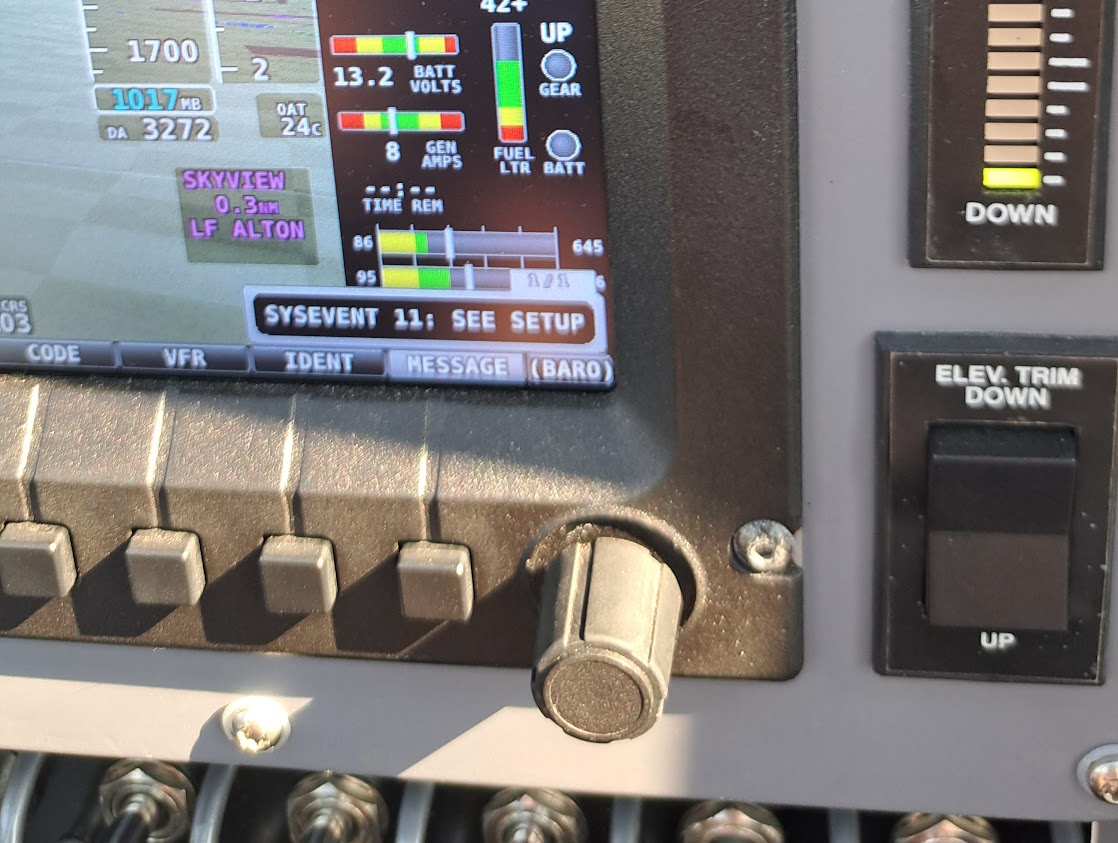

Anybody seen this or know what it is, please?
TIA
Paul

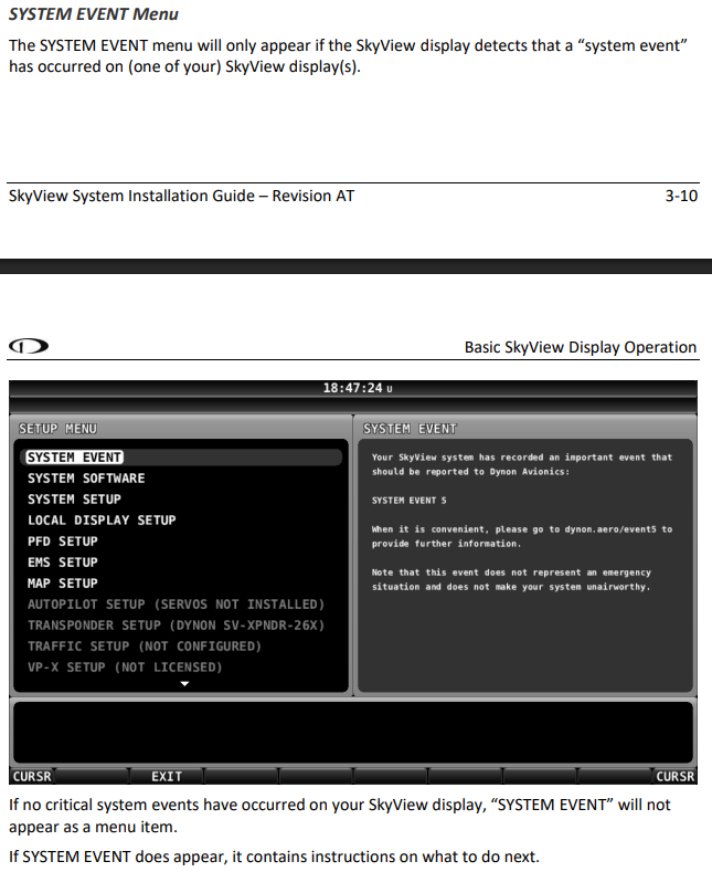

You could go into setup, and see what it tells you to do.
It will probably ask you to upload a diagnostics file.

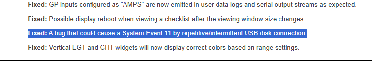

Looking through the software updates, it was addressed in 15.3.3
System event 11 has to do with an intermittent USB connection, so maybe start there. Try another USB.
Let us know how you get on.
No System Event menu, so I guess it was transient... 🤷‍♂️
Thanks for the pointer though - I'll know where to look next time...
