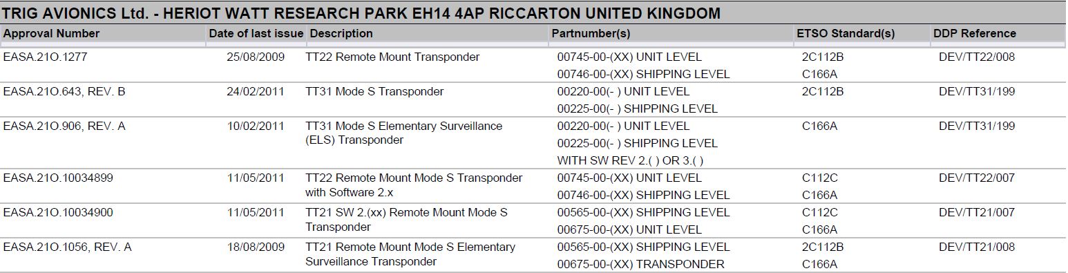

HI, I've tried to find the certification sheets for your transponders, the FAA TSO, the European ETSO etc. Are they anywhere available? I can not use the Dynon Transponder if I can not proof it has an ETSO approval here in Europe.
Would appreciate any feedback and if ETSO is not yet here is there a plan to have it approved? (Trig see attachement has them)

The actual Trig part numbers printed on the transponders themselves are 00745-00-03 (for the TT22 / SV-XPNDR-261) and 00675-00-003 (for the TT21 / SV-XPNDR-262), so it looks like they should be covered by those acceptances above.

Thanks a lot, appreciated, so the Transponder is a full fledged Trig unit then. Does that mean, that we will get as well the SW updae option on the Dynon units to get full ADS-B out at a certain point (http://www.trig-avionics.com/news.html)?

Yes, our transponder will get the ADS-B out compliance update shortly.
