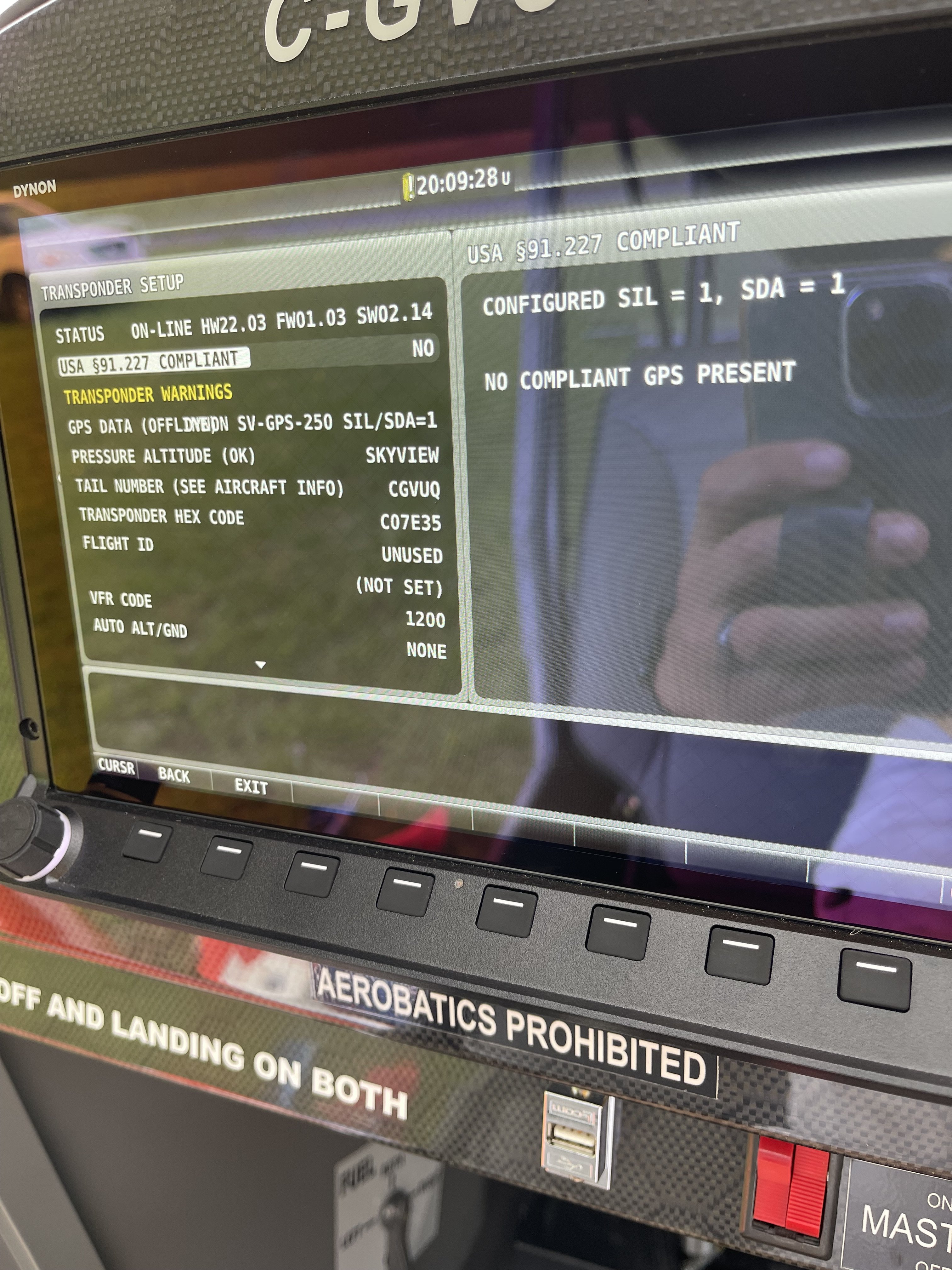

Hi,
I just started using the skyview HDX and the transponder was not working. I am seeing other planes with their call signs but the controllers could not see me. Has this happened to anyone and is there a fix for it?
Thank you,
Jon
2,256
Ok, so your ADSB IN is working & not related to Txpdr.
Can you post a screen shot of the Txpdr setup menu please, it would be most helpful ?
Are you able to select the transponder using the MENU button at bottom of the screen ?
1,708
Looks like your answer is right there..."GPS DATA (Offline)".
Your GPS is not working, or not connected, to SV.
You need to familiarize yourself with the installation and user's manuals to understand what's doing what (XPDR, GPS, ADS-B In, etc.) It's all in there.

Thank you, I’ll check the manuals again. But I flew 4 hours yesterday and I used the gps, it was working fine.
jon_grenier
Aug 19, 2023
6
Ok, I think that was the problem. The wrong type of GPS was listed in the transponder settings. I switched it to “Dynon SV-GPS-2020” and it now says “GPS DATA OK”
Thanks :)
