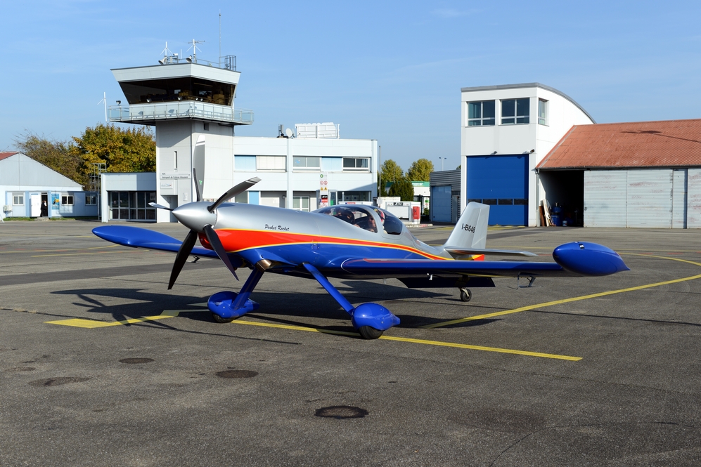

Hi, I just installed the Skyview in my Turbine Impulse called Pocket Rocket. Pitch and Rollservo with no play. Flying it manually requires small stickmovements especially in pitch and when above 200 KTS.
On the first flight with default settings I engaged the AP acc to the manual in Simple mode at 160 KTS and the Airplane rolled and pitched up after 3-5 sec. Since the plane requires small control movements, would you recommend to start with pitch and roll sensitivities near the lower end?
Thanks for any advice
Tom
