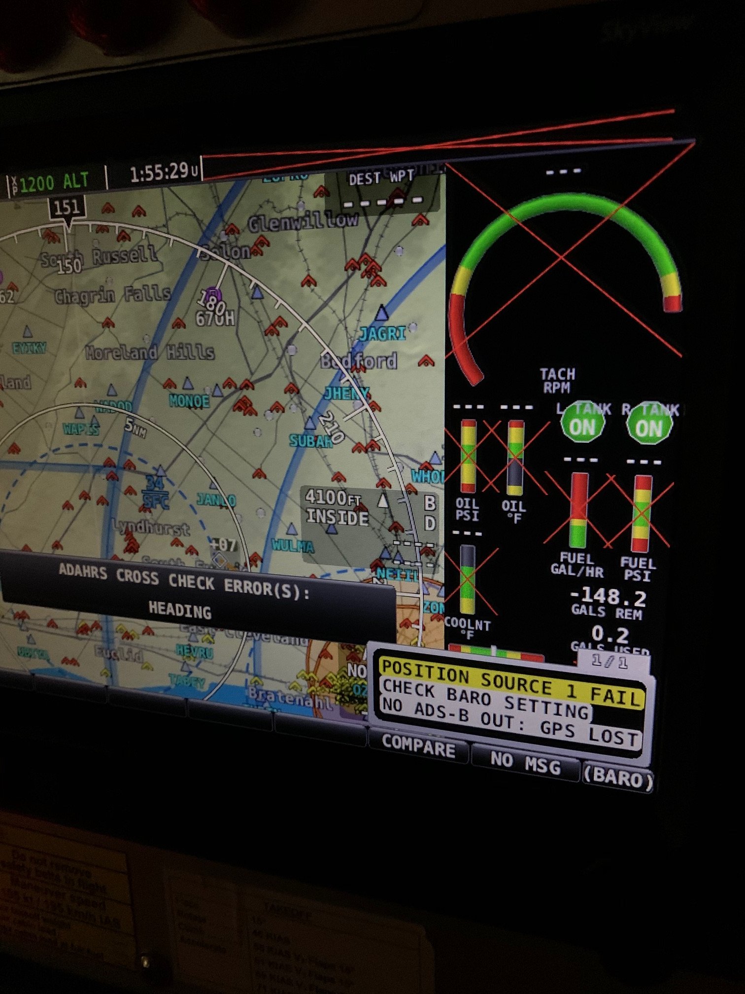

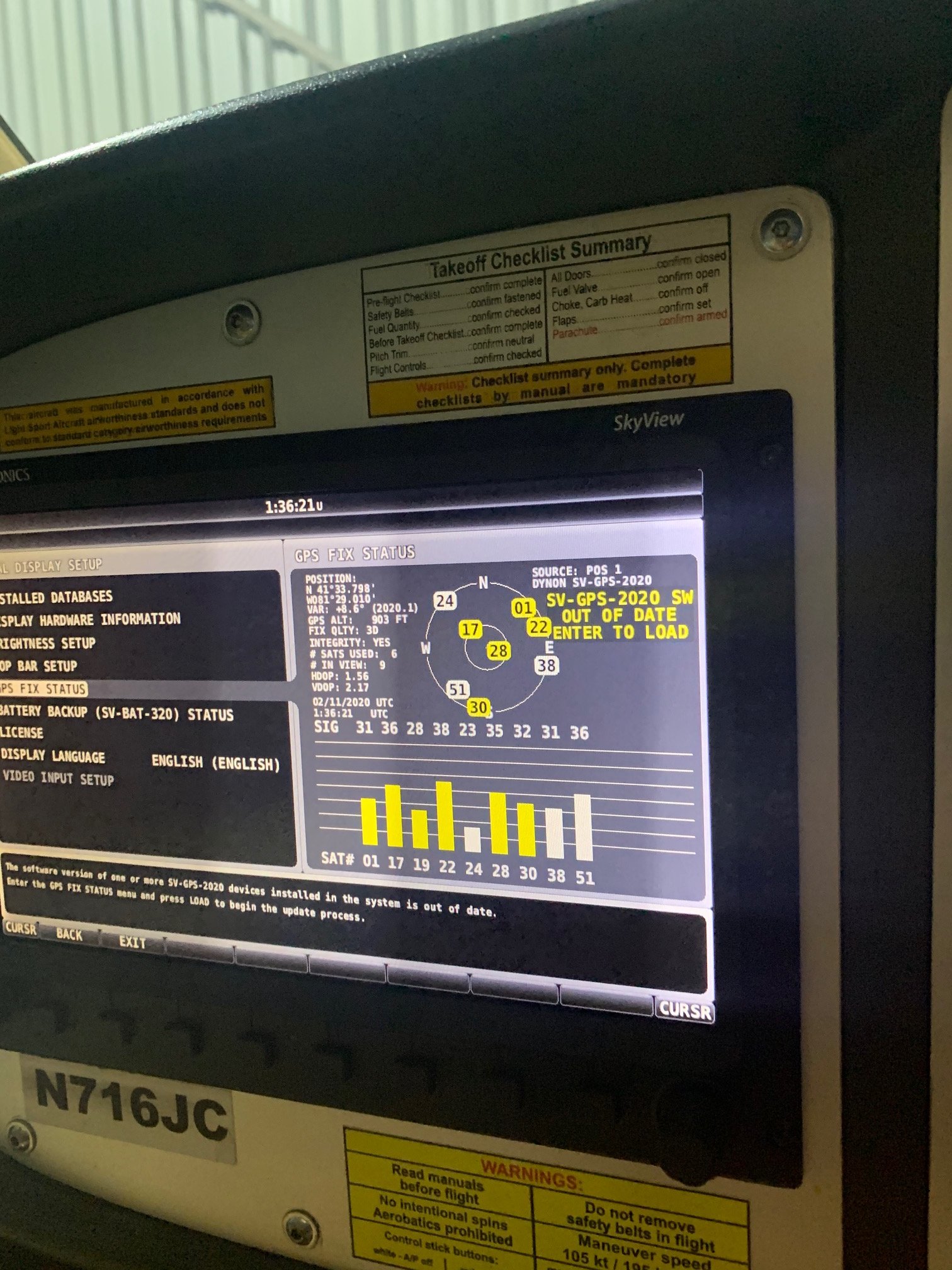

So I had a message that the software version of one or more of my SV-GPS-2020 devices installed was out of date and was told to enter the GPS FIX STATUS menu and press load to begin the update process. I pulled the plane out of the hangar and ran and successfully completed the update. When done I noticed I had two errors pop up when I exited the setup menu.
1) Position Source 1 FAIL
2)No ADS-B OUT : GPS LOST
I checked my ADS-B Status menu and it says
DEVICE: SV-ADSB-472
STATUS: NOT FOUND
Any ideas? I'm based out of a towered airport and was supposed to fly somewhere for maintenance tomorrow but I feel pretty confident I no longer have ADSB IN/OUT capabilities...

So after a reboot, it still can't find the ADS-B 472? That is your ADSB receiver- it is not found by the Dynon. Your ADS-B out is probably fine, as the GPS has a good lock and the transponder doesn't appear to have any errors. For some reason the SV-ADSB-472 receiver cannot be found. Go back into your network settings and see if something got buggered with regard to the SV-ADSB-472.

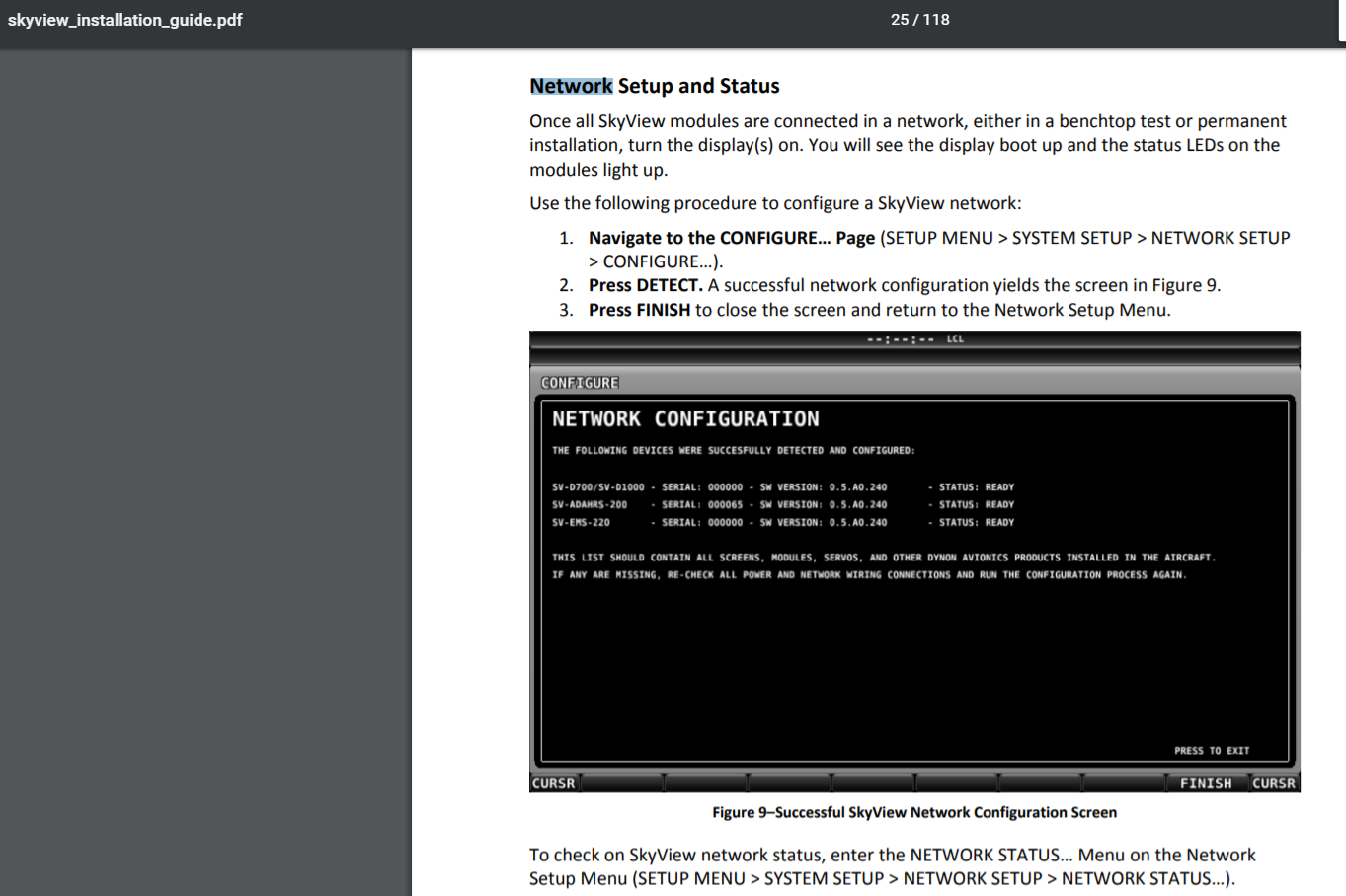

That's a pretty random way to make sure your systems are working properly.
First, did you read the installation manual?
Skyview Installation Manual pp. 4-19ff (too detailed to cut and paste here) covers the Network discovery and status options. You should have known how to do this.

I assume the below photo is the page you are speaking of?
